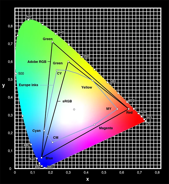

Yes Adobe RGB can describe more colors than sRGB. The same RGB number will result in a different color.
This diagram simulates all colors humans can see. A lot of them cannot be reproduced in print or on a screen. Look at the Adobe RGB green and sRGB green and how far they are apart.

What you could change is your RGB working space to sRGB. Adobe RGB is a much larger working space than sRGB and meant to be used for photography. For web and screen display, sRGB is the working space to use. If you open your CMYK documents with sRGB as RGB working space in your Color Settings (which is what you get with the Europe General Purpose preset), you can see the sRGB values in the Color Panel/Color Picker.

Europe Prepress is not a good preset when you want to work for the web. Adobe RGB can contain many colors that do not exist in sRGB, and sRGB is what most web browsers expect by default.
