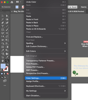

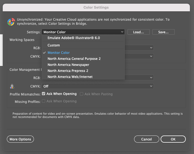

I was having the same issue after updating to Illustrator 2021. I think I found the solution.
Edit > Color SettingsMonitor Color
Screen Shot 2021-04-06 at 1.47.39 PM.pngScreen Shot 2021-04-06 at 1.45.17 PM.png

3 Color settings changing to emulate illustrator 6
There is a bug caused by the recent Photoshop update. It sets your Illustrator Color Settings to Emulate Illustrator 6, which turns color management off.
If that is the case, use the CC app to revert Photoshop to the Previous version (22.2.0) and then change your Color Settings to what you want it to be.
