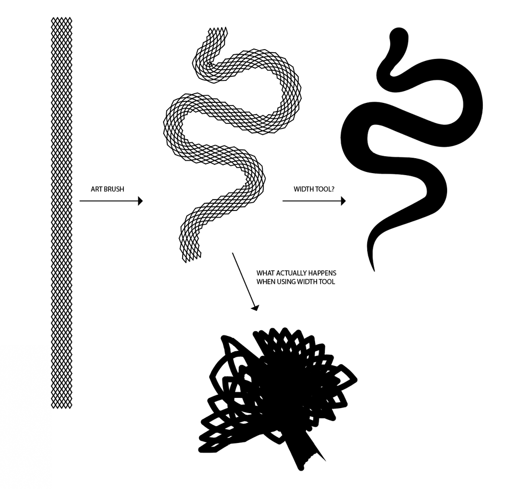

I was hoping to quickly create a pattern to be used as texture for a snake.
I created the pattern and turned it into an Art Brush. Then I applied the Art Brush to a line; works perfectly.
Then I hoped to just use the Width Tool in order to adjust the pattern to go smaller or wider in certain areas; total fail.
You can see what I mean in the image below.
Any ideas on how to solve this?
Thanks a bunch!

Sep 17, 2019 Sep 17, 2019
Did you outline the strokes before creating the brush?
Explorer ,
No because I dont want to vary the line width
Explorer ,
I do get somewhere expanding the brush and the using the Warp Tool to shift it in place. But then I use the mathematical feel it has now because lines get jagged a bit.
It makes totally sense to have live strokes in brushes. But it breaks when you do exactly this (applying variable width)
Explorer ,
So I just tested with expand strokes -although I would want the same stroke width- and it is less bad. But I have to drag the stroke width to about 1000% of what it actually is when released.

Sep 18, 2019 Sep 18, 2019
At the bottom of the stroke window you'll find the width profile presets. See Mike's first screenshot above. You first use the width tool on a stroke and then save it there.
Explorer ,
Sep 22, 2019 Sep 22, 2019
Thanks all for the great tips, I'm suprised by how quick the qualitative input arrived.
For future reference; I did get the best result using these steps;
  1. create the variable width stroke (width tool) first with a solid stroke
  2. save the variable width as a variable width profile (bottom of stroke panel)
  3. create a long art brush (rather than a pattern brush; the pattern brush is easier to manipulate, but leaves unwanted gaps)
  4. apply the art brush to the stroke
  5. apply the previously saved variable width profile
The result is a mathematically looking pattern width a consistent stroke width (because strokes werent expanded)
