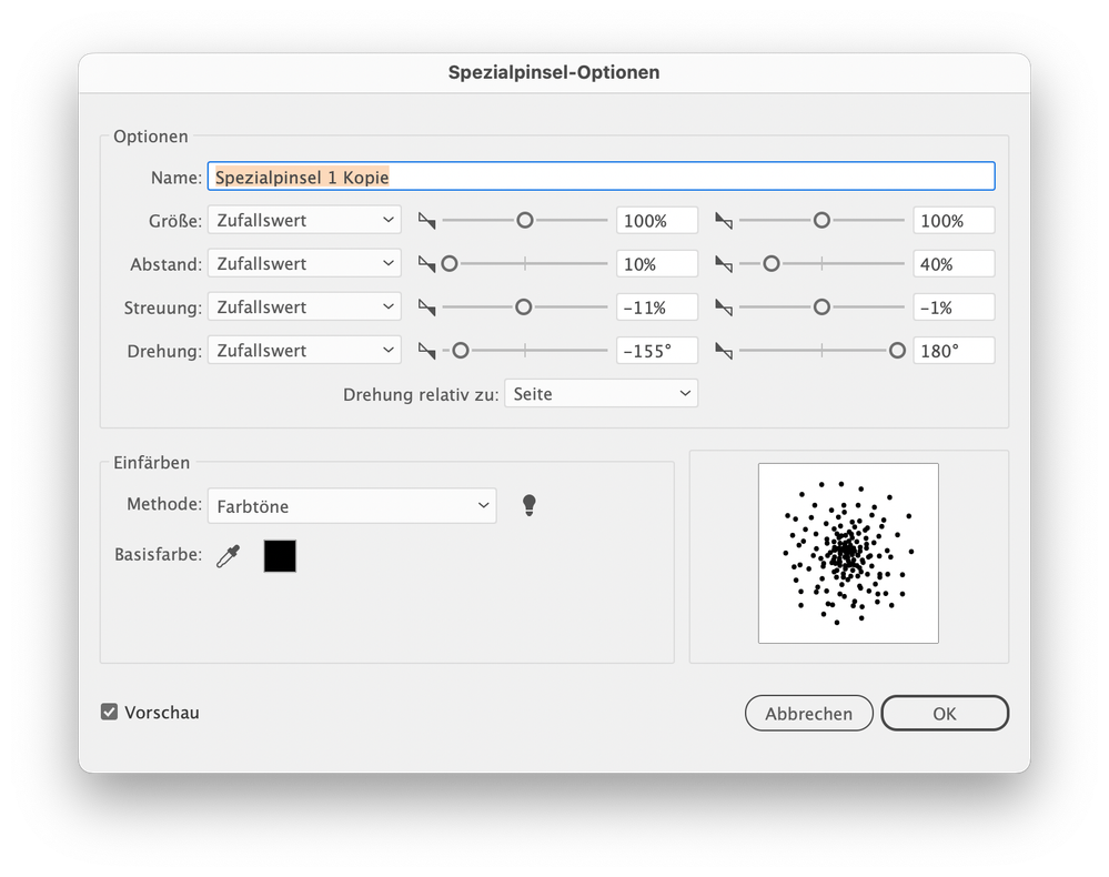

Make a pattern like this
Create a scatter brush
Apply scatter brush to circle
Apply clipping mask to the circle
