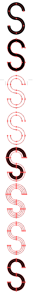

I am trying to convert a solid fill object (see attached image) into a single line.
The reason I want to do this is so that I can make the solid fill object thinner.
If it was a single line, this would be easy, because I could simply reduce the stroke of the line and have control over how thin the line was.
Is this possible please without having to re-draw it.
Thank you.
    Correct answer Jacob Bugge
    James,
    Here is an improved description, and a set of screenshots (using a Helvetica S):
    1) With the Direct Selection Tool (first deselect by Clicking an empty spot and then) Click each end path segment and press Delete (that will give you two paths forming the curved parts);
    2) Select everything and switch from Fill to Stroke in the Toolbox (that will give you stroked paths (and you can see what you are doing));
    3) Object>Blend>Blend Options, set Spacing to Specified Step with 1 step (that will prepare the right blend);
    4) Select everything and Object>Blend>Make, then Object>Blend>Expand, then Ctrl/Cmd+Shift+G to Ungroup, then hide or delete both the original paths (that will give you the stroked path midway between the curved paths), then set the Stroke Weight as desired (in the screenshot both paths are kept to show that the middle path fits).

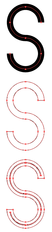

    Jacob Bugge
    October 5, 2015
    Antistandard,
    You may (save a copy of the original path so you can fall back on it):
    1) With the Direct Selection Tool Click each end path segment and press Delete (that will give you two paths forming the curved parts);
    4) Select everything and Object>Blend>Make, then Object>Expand Appearance, then delete both the original paths (that will give you the stroked path midway between the curved paths), then set the Stroke Weight as desired..

    Jacob Bugge
    October 6, 2015
    James,
    What happens if you click the end path segments as suggested in 1), not the Anchor Points (just Click between them), then go on as suggested? That should ensure that you only have the two curved paths.
    As far as I can see the (negative) Offset Path will make the resulting path shorter, and it will still result in a filled path instead of a path with an easily (re)adjustable Stroke Weight.
    And as far as I can see, the filled path must have started out as a stroked path that was Object>Path>Outline Stroke. So if the original path is hidden somewhere, you can just use it again. Without that, the 1 step blend may be seen as the reversal to it (as accurately as can be done).
