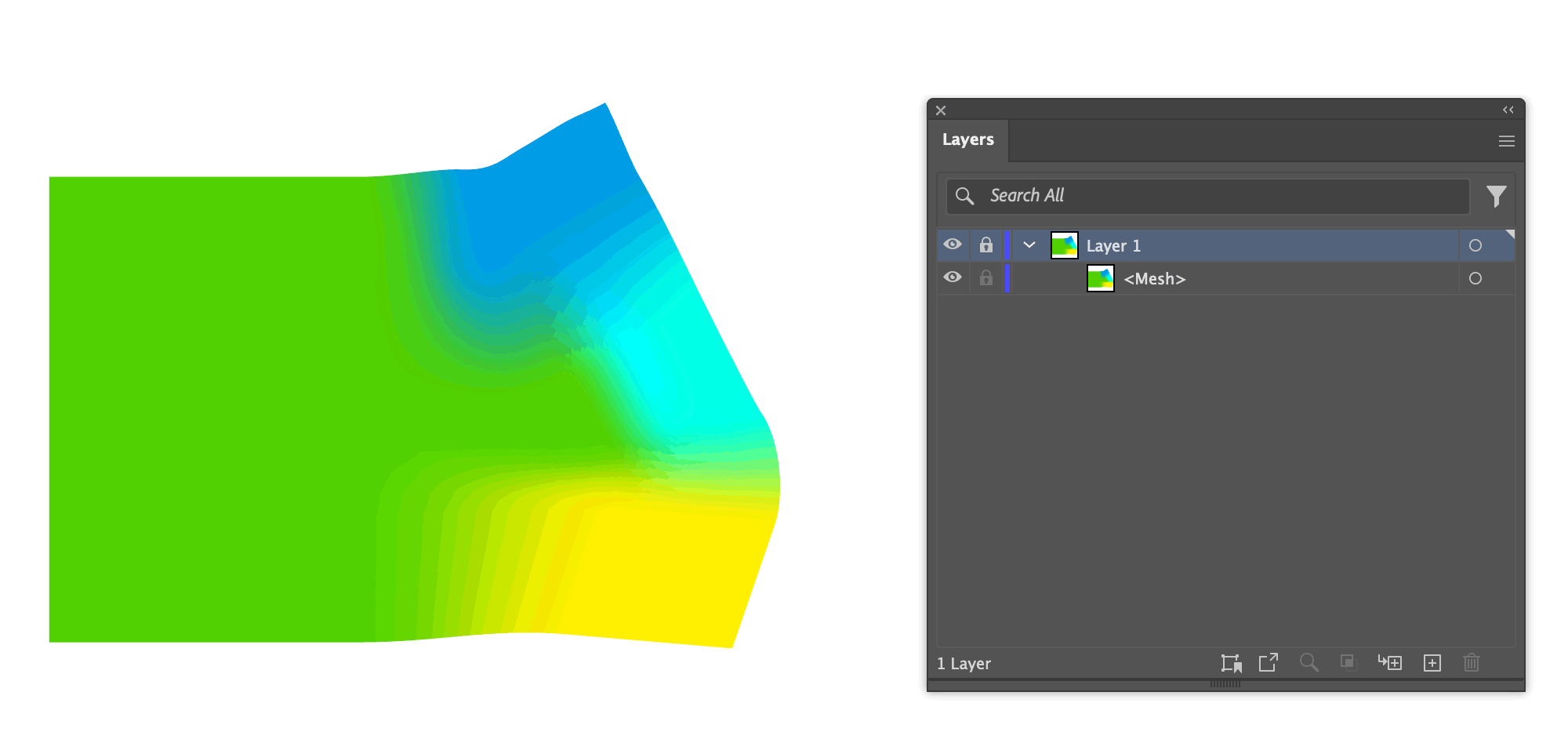

For some reason it would not let me upload the .jsx file, however, I have attached a plain text version.
chadulus2Author
October 13, 2025
I have tried a few things and seems to have gotten the script to actually work....well, whether it does what I want is another question, but at least I can get Illustrator to run the script.
