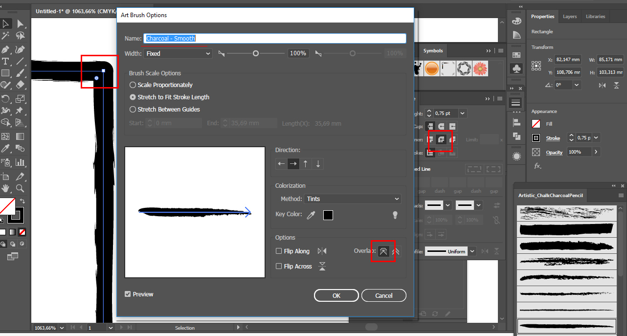

Here is a checking sample of a pre-installed Charcoal Soft brush (other brushes work the same way, whether they are pre-installed or not). Is it what you need?
Jan 31, 2018 Jan 31, 2018
Usually it won't get round with that setting.
Well, I also think that it's not a very good idea, it doesn't look too smooth or elegant. I just checked if it exists. But, for me, the normal way with rounded corners would be better visually and technically.
