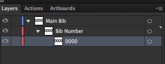

Ok, so I just went ahead and made a couple of assumptions to get you something to start with. This could be easily edited to fit your needs.
The assumptions:
a template file that contains the following layer structure:
Main Bib is the top level, container layer that will hold all subsequent bib numbers.
Bib Number is a temporary layer with which we will model the other sublayers.
0000 is simply a text frame inside of the Bib Number layer.
*Note* the screenshot shows 4 digits, 0000, but the code below does not zero fill. It will simply input the sequence number.

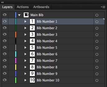

The result:
A file with one main 'container' layer called "Main Bib".
1 individual sub layer per sequence number named "Bib Number #"
     each sublayer contains a single text frame whose contents are the sequence number.
The next step:
Another function can be written to hide all of the layers, then unhide each layer, 1 at a time and export a print file to the desired location.
