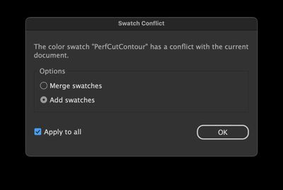

For this to work PerfCutContour needs to be set as a global color in all files
Then record an action that:
  1. pastes in your clipboard with a swatch with the updated color.
  2. in swatches select the good color, then shift select the old color, and use swatches flyout menu to merge colors
  3. The hit delete key to delete selected item you pasted.
