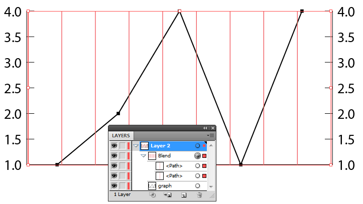

Maggern, what about a different approach? what if you leave the tick marks off completely and draw them by hand (or perhaps by script) separately?
I drew two lines and used a blend between them in no time
