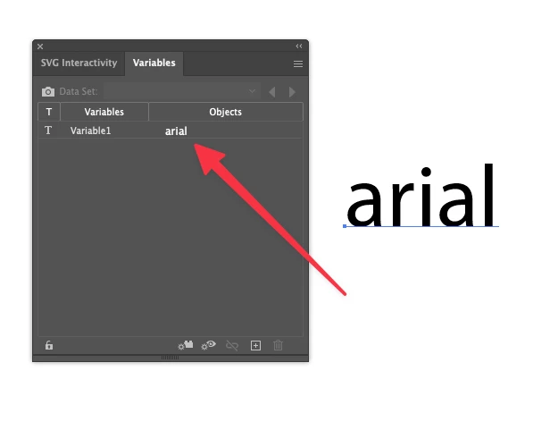

jduncan
October 12, 2022
The below works for me. I created a single text variable with the text "arial" and this returns exactly that. The first item in the 'sgreg.pageItems' should be a TextFrame so you could dig deeper for more info if you needed to.
sgreg.pageItems[0].contents

Makes sense, but I'm getting this error.  Trying a few things to get string value. toString, and some others. I'm on windows. CC illustrator.
jduncan
jduncanCommunity ExpertCorrect answer
October 12, 2022
Yes, it's because your variable isn't actually bound to an object, it is just an empty variable. If you compare your variables palette to mine attached, you can see that you have nothing listed for "Object". That "object" is the page item the variable is linked to. So when you try to access 'sgreg.pageItems[0]' you are getting an error because there are no page items actually bound to that variable.
