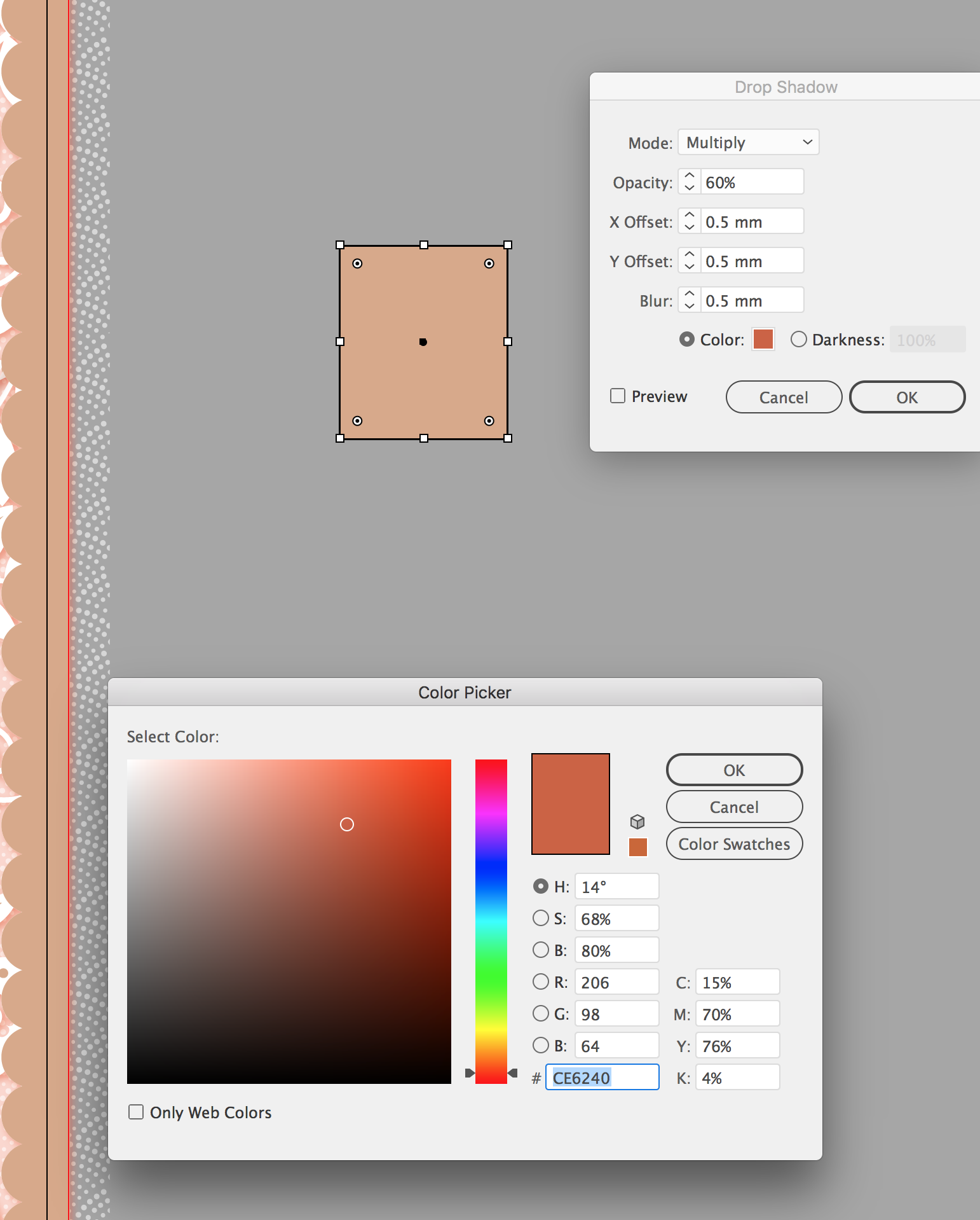

Im sure that i used to be able to apply a drop shadow and select a colour for using the eye dropper that appeared when i got to this stage:
however now theres no eye dropper that appears... so i'm not able to select a colour from an image on the page to use for my drop shadow.  I can only select from the colour picker window now.
Am i going mad, or confusing photoshop / illustrator / indesign???
