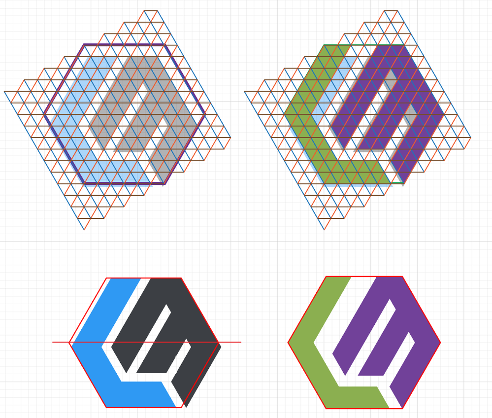

I'm trying to fit a design into a pentagone through envelope distort but not getting the desired result.
I have attached an image for referance.
Please help.
Regards
Basant

Basant Mishra, Hi.
True, grids are everything.
For your given vector shape to fit exactly into a hexagon shape, hmm, there a problem here.
Here I have a seamless hexagon pattern. Hexagon is compromised of equilateral triangles.
I did Live Paint, following your design. No problem I thought.
So I redid. COUNT your triangles!
As you can see, there is a gaping negative space but now fits into a true hexagon shape.
K
July 13, 2024
Thank you for the taking the time to redo the design.
But fitting the design in hexagone is not the only goal. The design should look asthetically pleaseing.
The gap towards top is twice compared to other ones.
How do you make it all same width and still fit in the hexagone?
Monika Gause
July 13, 2024
You can make the grid as small as you want and then you can make it fit.

The original blue and black icon looks hexagon shaped, but in an uneven manner (the top of the icon looks more narrow than the bottom). Are you trying to fit the design into an equalateral hexagon shaped container? If that is the case then the blue and black graphic will have to be re-built using the even hexagon shape as a source to build up the straight intersecting diagonal lines. It's not hard to do at all, but it will take a bit of path and shape editing to do the job. Using envelopes or other similar effects will only warp the original graphic and cause the straight line work to curve in undesireable ways.
