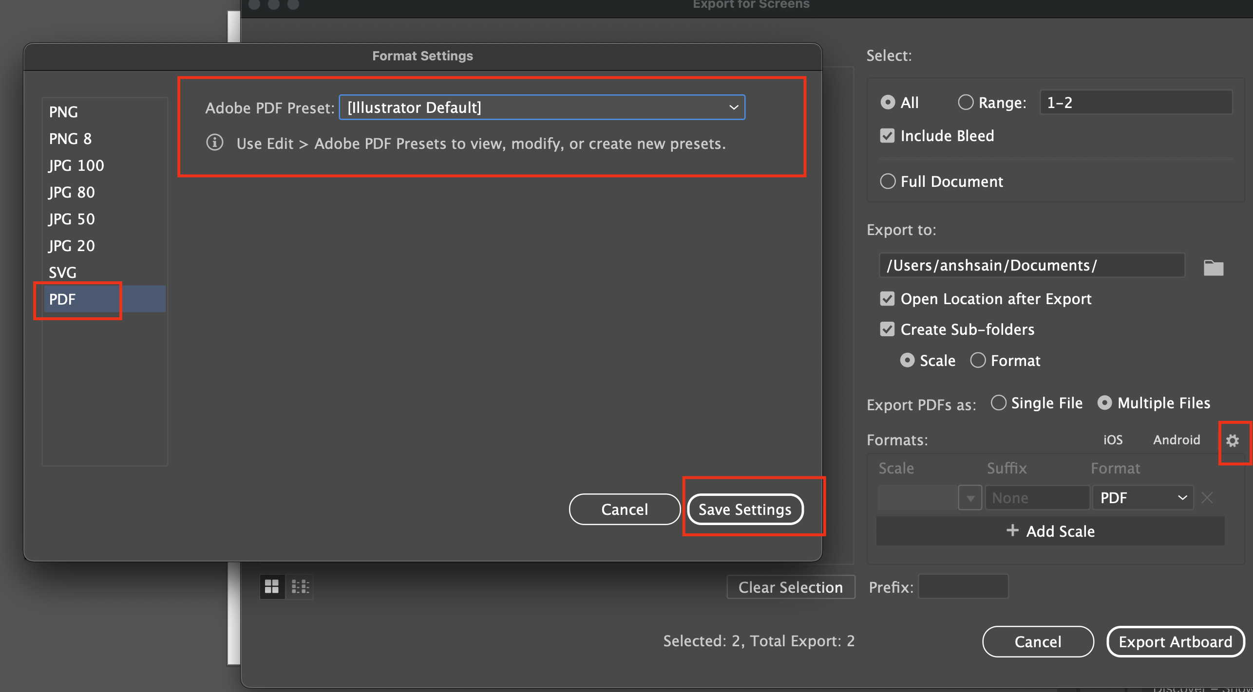

Hi @valeriu2809,
Thanks for reaching out. In addition to Kevin's suggestion, would you mind selecting the "Illustrator default" preset in the export settings of PDF in export for screens and confirm if that helps or not?

Community Beginner ,
Aug 24, 2022 Aug 24, 2022
That is the exact setting we're exporting them with, since we need all pdfs to be editable (keep layers etc), so unfortunately it doesn't do anything, but thanks for the reply :)!
