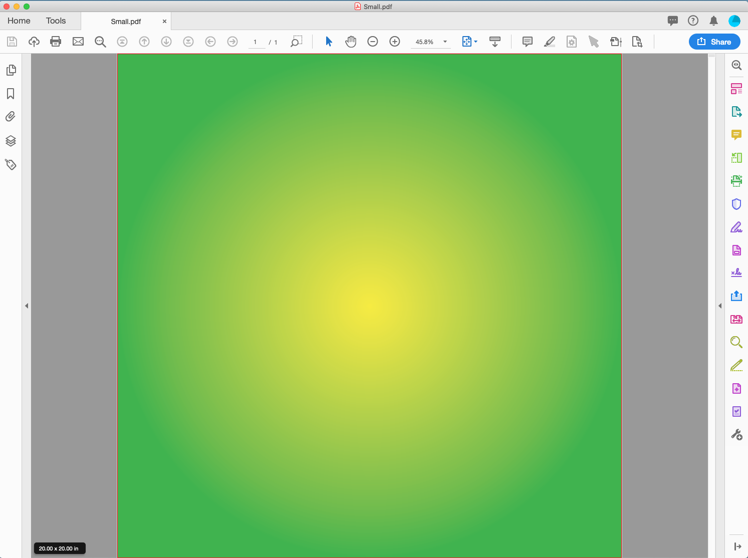

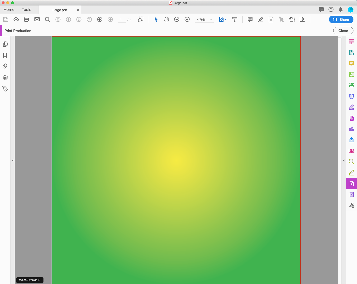

I agree there is little reason to increase the file size, that is usually done at the printing step, however to answer your question, you can use Acrobat to change the size of a PDF.
Go to Tools> Print Production> Preflight Fixups (blue wrench icon), under the Pages Fixups, find, duplicate and re-name the profile Scale pages to specified size. You need to make a copy of it in order to unlock it and allow changes to the settings. After making your changes, save the new profile, With the PDF open, click on Fix at the bottom right corner and give your PDF a new name. In this example I scaled a 20 x 20" PDF to 200 x 200". You can choose either a specific destination size or percent.
