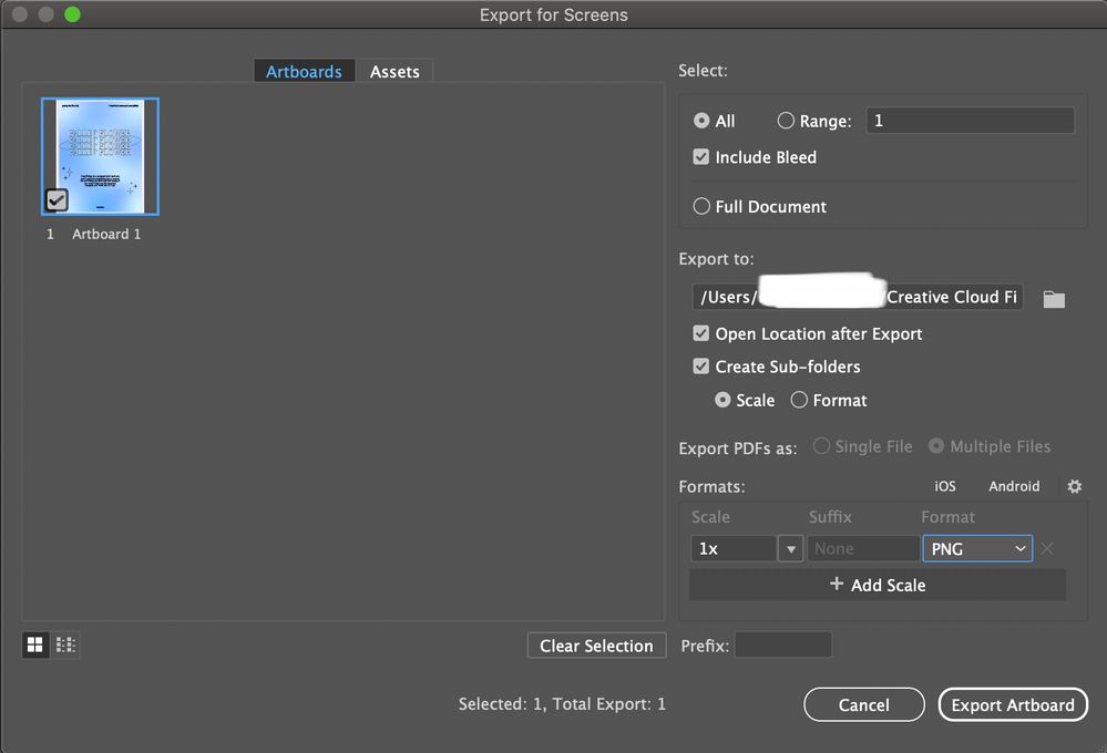

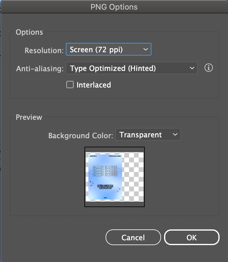

can you share a screenshot of the png settings dialog right before you export them?
bonus points if we can also see the png image next to the dialog, if possible.

Screen Shot 2022-08-25 at 12.03.09 AM.pngScreen Shot 2022-08-25 at 12.03.27 AM.jpg
For the above picture, I have also tried exporting in JPG 100 (not too sure what this meant) and got the same blurry results.

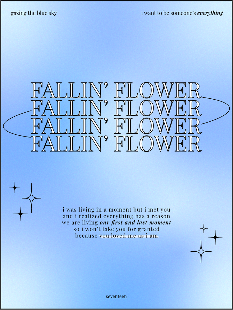

The above photo is what I see on my screen in Illustrator

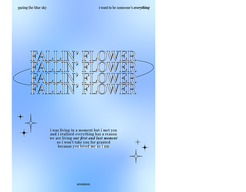

The above photo is how it exports when choosing "Export>Export As>Export as PNG"
Aug 25, 2022 Aug 25, 2022
Your iPhone display has a higher resolution as 72 ppi. You could try 2X or 144ppi to see if that improves.

Thank you! I will try this. I didn't know that I would have to change the resolution (didn't know what that meant at all really) so I'm sure this will fix it.
