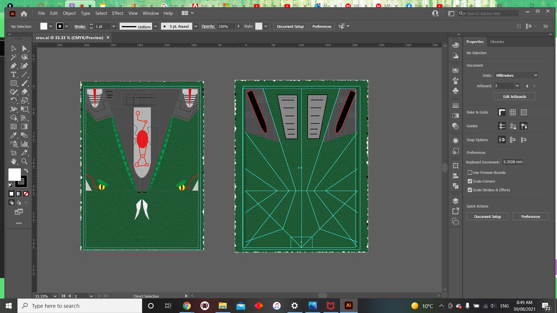

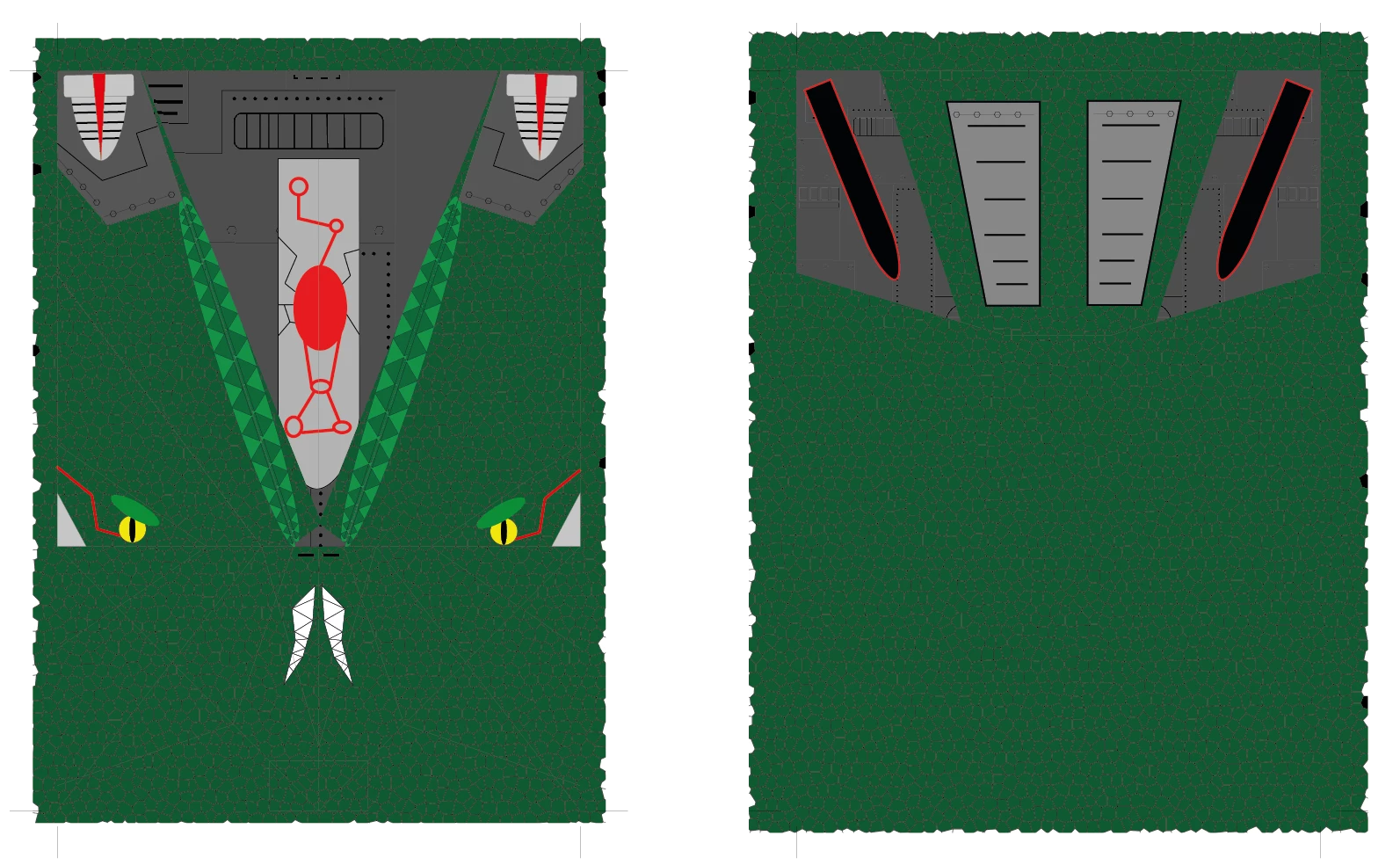

OK, so I'm trying to export something (whether as an image or PDF) that's supposed to look like this:
But when it's exported various artifacts show up like this:
Look at the centre of the first panel, there are two spines instead of one cut in two...
How do I fix this and export everything properly?

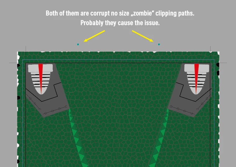

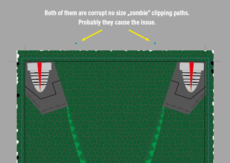

I recommend to clean up this foul construction.
The two zombie clipping paths I already mentioned are corrupt objects. Normally they should not even be able to clip anything, but for some unknown reason they actually do clip an area. You can see it if you locate them in the Layers palette and then hide them.
Furthermore there are two other dubious (open) clipping paths (right below the zombies) which should probably be removed as well.

August 31, 2021
There is a very complex structure 🙂
But what you can do quickly: change the order of the layers. Move the Top of Wings and Top of Wings copy layers under the Page Outline layer. Then the main gray shape ( = crocodile's head) looks fine after export.

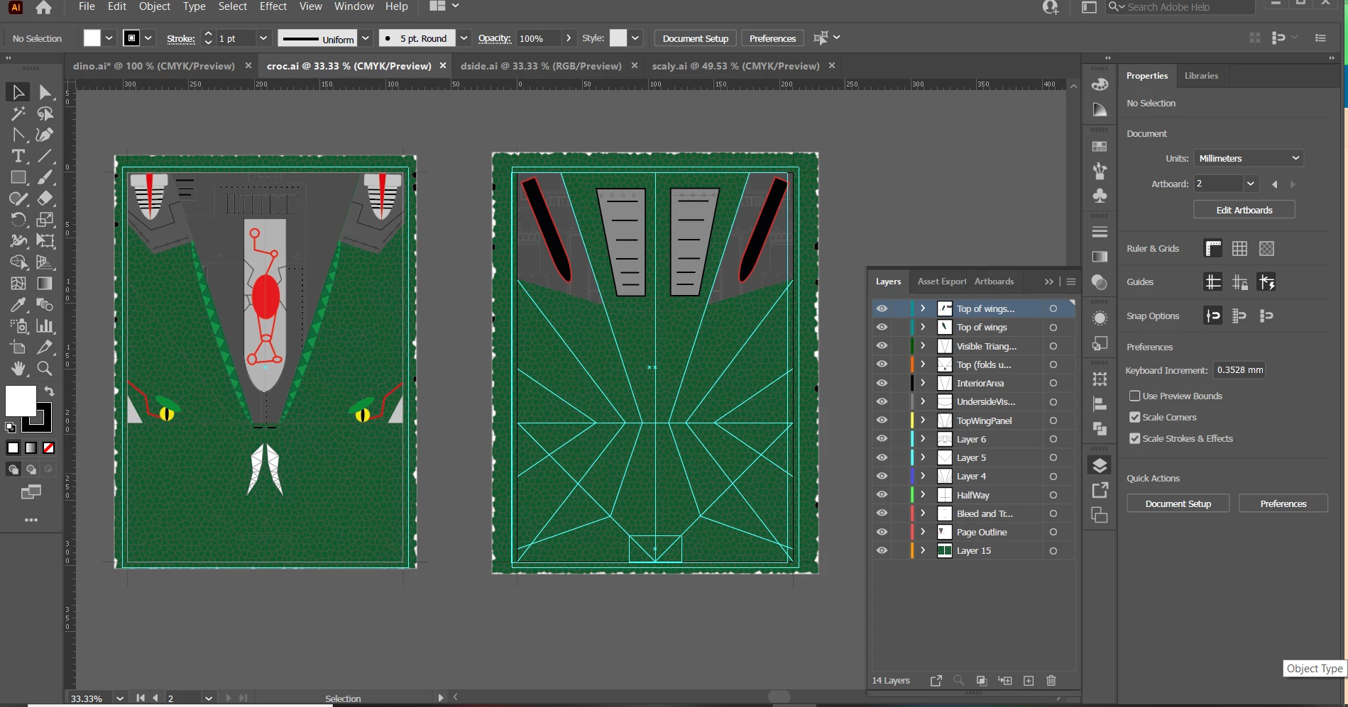

Anna Lander
August 31, 2021
Show please the Layers panel expended? it seems there may be some useful info.
