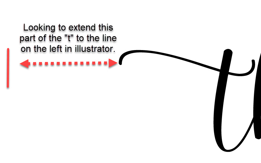

I am looking to extend the swash of the character in the attached image. I am a begginer with illustrator (i know enough to get by most times) I only want the line extended and not the rest of the "t".
using illustrator 23.1 (CC2019)
Thank you for any help.
Bill

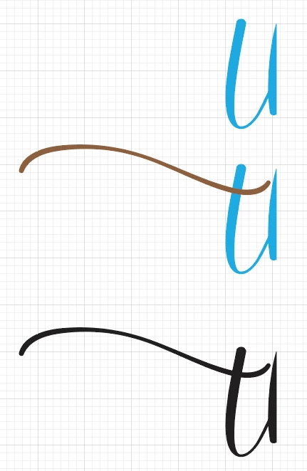

    My vote would be to Outline text and
    totally delete that existing swash of the t character.
    Shown in Cyan.  A closed filled path.
    Easy to create your own Swash!
    Draw a new stroke path.
    The Pencil Tool and the Width tool are your friends here.
    Duplicate for safety
    Finally Expand your stroke, now both are fills. One color
    Pathfinders> Unite
    K

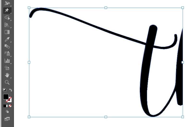

    One quick option if you have CC 2019 is to usse the puppet warp tool, very easy...

    If you select Type > Create Outlines you will be able to modify the swash.
    October 9, 2019
    I did that but I am not sure how to modify just the swatch. I tried the pen tool with no success on how I wanted to extend it.
    rcraighead
    October 9, 2019
    Use the "Direct Select" tool to select just the points you want to move or edit.
