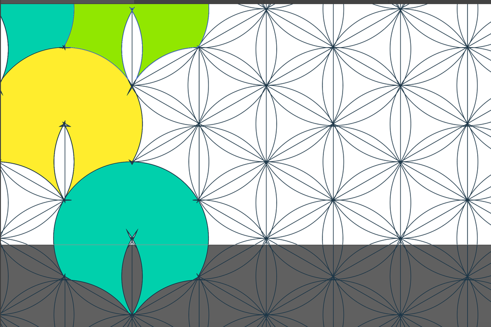

Hi , i am creating flower of life pattern based on hexagonal grid. It needs to be precise  but there are certain problems.
  I created 60 degree angles 2 grids, then created vertical lines grid.
115 px is a radius of my circles which equals to 230 px of hight of width. When I draw a circle 230 px from the centre of the hexagon it does not touch the corners of the hexagon, please check pictures below.
So when I try to create pattern I struggle to align all circles to centres and it creates gaps, and imperfections. This means that if I will try to cut the pattern I will be left with a lot of bits. Please help me to solve thisScreenshot 2024-01-05 at 18.45.54.png mistery...Screenshot 2024-01-05 at 17.26.06.pngScreenshot 2024-01-05 at 17.32.34.pngScreenshot 2024-01-05 at 17.33.04.pngScreenshot 2024-01-05 at 17.41.28.pngScreenshot 2024-01-05 at 18.00.51.pngScreenshot 2024-01-05 at 18.42.00.png

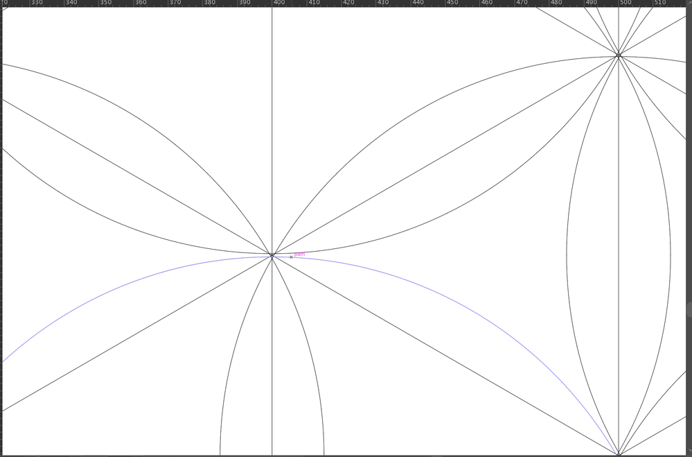

Bezier circles are not perfect and you will never get a perfect result by transforming the hexagon and the circle together.
In this example, viewed in CPU Outline view and enlarged 64000% there are only 2 places where the circle and polygon touch.
Jan 05, 2024 Jan 05, 2024
Illustrator has some rounding errors. As Ton said, the shapes are not perfect.
