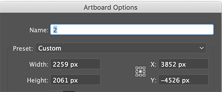

I see what is causing your problem, you measure from the center.
I also see why you cannot rearrange artboardx, the working area is too full to move them.
Here is your artboard 2, the X Y looks good, but you are measuring from the center.
Here is what happens when you measure from the upper left (which is where the pixelgrid origin starts), you get fractional pixels.
When you correct these fractional X Y coordintates, no additional pixels will be generated when you export at 72 ppi.
