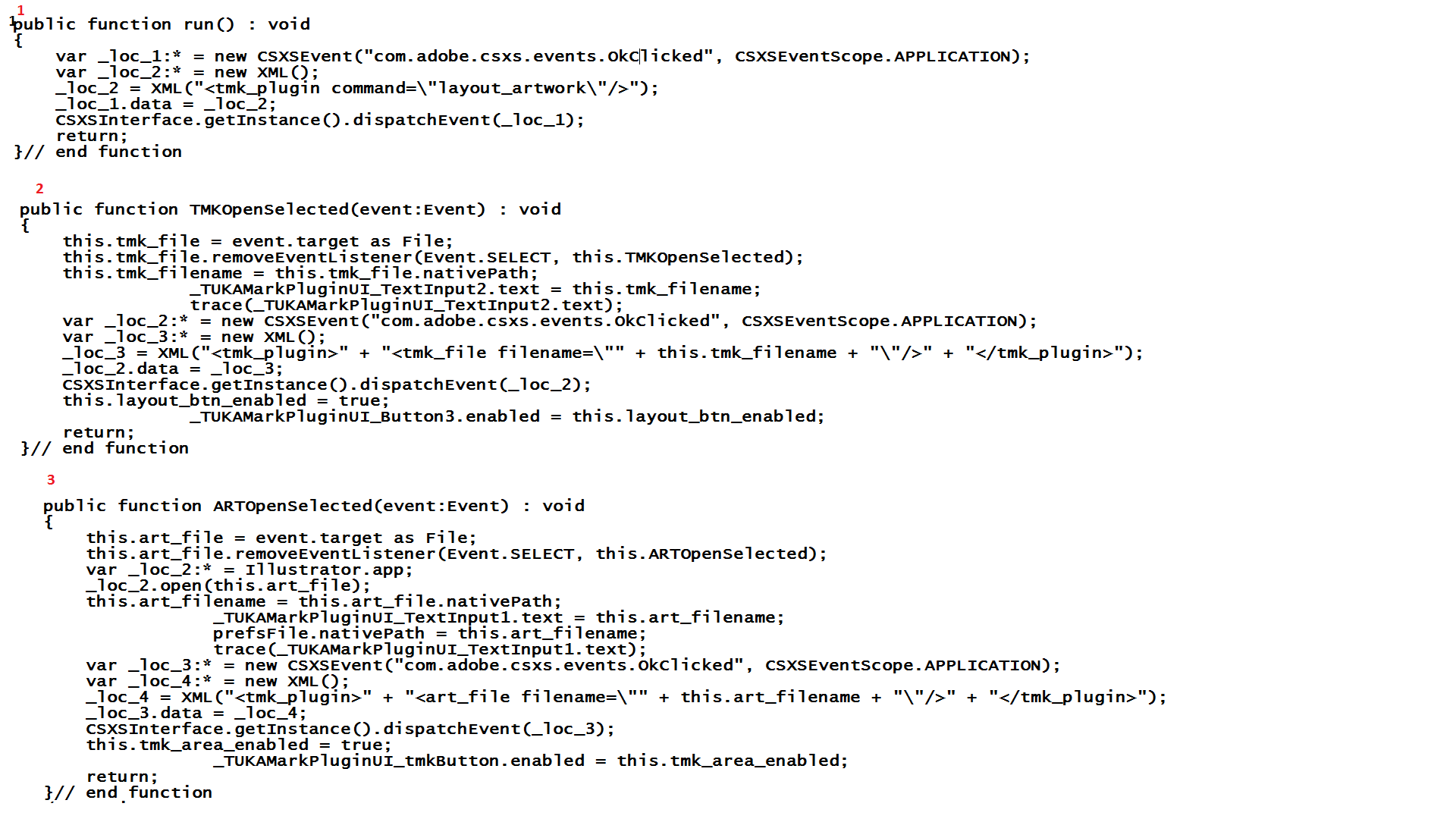

Yes my plugin code trying to access Click event parameter.
there is no any OkClicked method defined inside  xml file.
Please send me your email id I am sending my plugin UI code
and check.
Regards
Kundan
Engaged ,
May 24, 2016 May 24, 2016
Please find the click event code inside the mxml file
Please find it.
Regards
Kundan

Engaged ,
May 26, 2016 May 26, 2016
Thanks for reply.
What is the third parameter(data) in CSXSEvent function.
In my given swf file code there is two parameter
var _loc_1:* = new CSXSEvent("com.adobe.csxs.events.OkClicked", CSXSEventScope.APPLICATION);
so Please suggest what will be the third parameter here.
Regards
Kundan
Advocate ,
May 27, 2016 May 27, 2016
_loc_2 perhaps?
Enthusiast ,
Data object was declared and defined just above in my sample.
Like Leo told you before, this should be _loc_2 in your sample.
