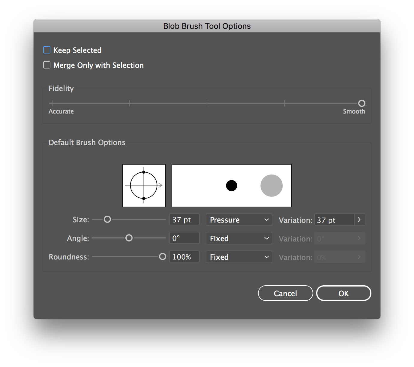

Are you saying that the device is not pressure sensitive in Illustrator? If so, please understand that the pencil tool is not pressure sensitive, it lays down a mono weight stroke always. You can modify it after the fact with the variable width tool though.
If you want to draw with pressure sensitivity and get variable widths as you draw, you can use the blob brush tool. Be sure to double click the blob brush icon in the tool panel to bring up the tool settings and turn the pressure sensitivity on.

So I activated the pressure sensitivity in blob brush tool settings, it
didn't work. I tried my Huion with another laptop and it's working just
fine with illustrator. Also if I draw something using the mouse, the huion
pen is only working as an eraser tool and nothing else.
