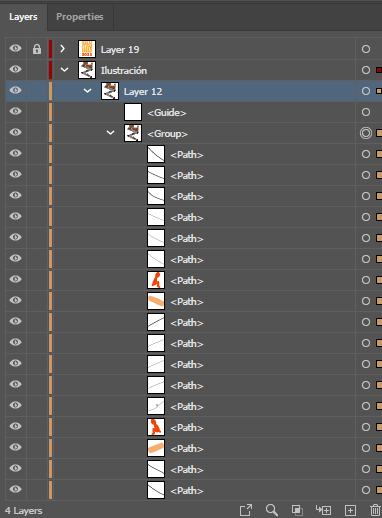

When I group together (control + G) all groups that I have named beforehand, what I get is a new group that contains all the layers from all the preveious groups, while said groups remain empty outside the new group. Now the align tool works how I wanted but the structure inside the new grouo is chaos.
Is there a way to group groups keeping the structure and names intact?

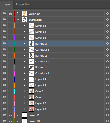

Thanks a lot for your answer. I did what you suggested but it did no work. I think it is becuase I did not explained myself clearly. Here is what I did:
I had a lot of grups with names, I created a new layer (ilustratación) and I dragged all the groups inside. I did not use "Control + G". If I use "Control + G" the groups desappear.
In this picture you see the structure after I dragged all the groups into the new layer. You can see Layer 12, 13, 14 and Barrera 3.
Here you can see what happens when I use "Control + G". If I rename Layer 12 to "Ilustración" and drag it out, I still dont have the structure with the groups and its names.

You seem to be using groups and sublayers interchangeably. Sublayers are just organisational folders; they don't affect how objects behave.  This is what I think you want to do:
1. Create groups from each named sublayer. Rename them to match the former sublayer.
2. Group all the new groups into a group called 'ilustración'.
I don't know of a way to do this automatically without creating/renaming each individual group.

Thanks a lot, that is exactly what I ended up doing and it worked :). Thanks a lot for your help!
