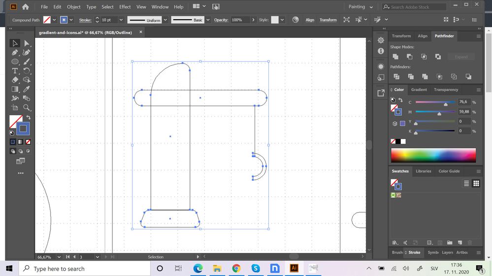

How are these objects constructed? Can we see outline mode?
Participant ,
Nov 17, 2020 Nov 17, 2020
Thanks for your answer. I'm sending an outline mode:
Maja,
The images look as if the half circle was a closed fill/nostroke path (maybe made by outlining an original(ly) stroked path like the others), that has turned into stroke/nofill like the rest of the Compound Path; and the stroke fills the inside (like the fill did) and adds to the total thickness.

Dear Jacob, you are totally right! I was working on an old version!
If I do a circle in a proper way:
  • as a stroke circle
  • and cut it by half with a direct selection tool and delete
then everything works just fine.
