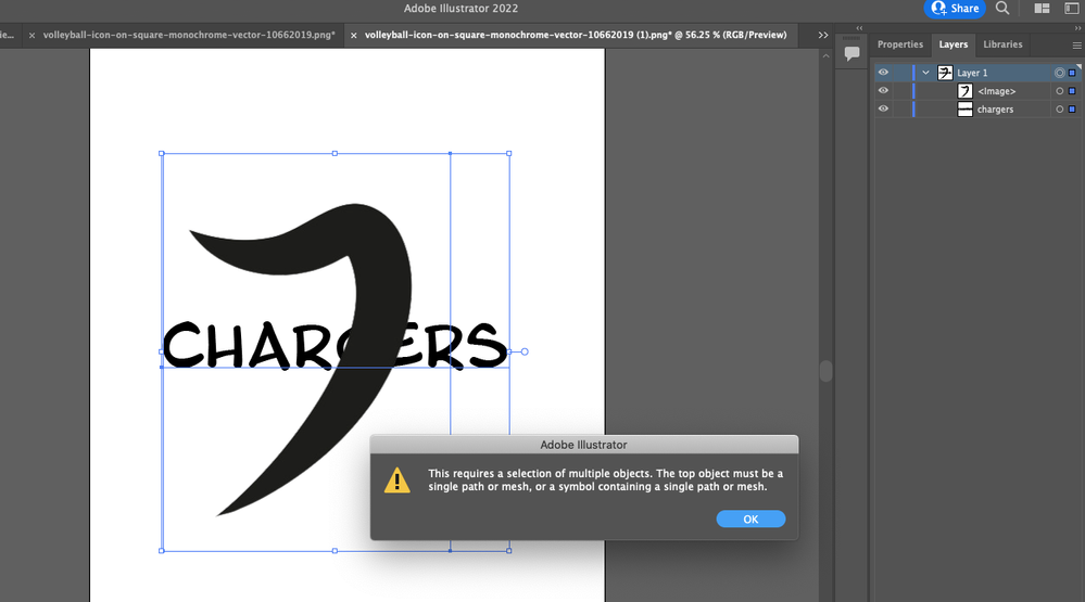

New Here ,
Aug 27, 2022 Aug 27, 2022
I am having a similar problem, have read through the suggestions, but still have had no success.. Does anyone have any further thoughts?Screen Shot 2022-08-27 at 10.15.48 PM.png
Aug 28, 2022 Aug 28, 2022
It looks like in the layers panel that you are using an image as top object. This should be a vector path.
New Here ,
Is there a way to convert an image to a vector path?
Window > Image Trace.
Advanced > Ignore White
