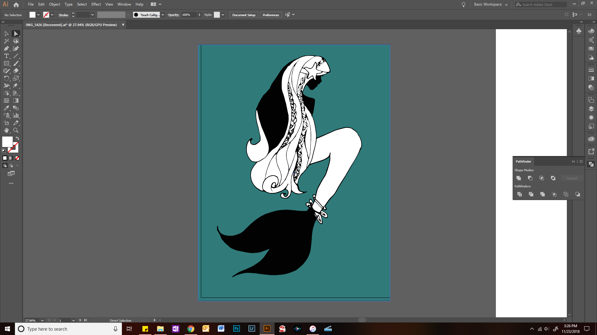

I'm trying to turn one of my line drawings into vector art to use for cards. Here's the drawing: .png)
I've already Image Traced it, and I am happy with the results. The only problem is that I'd like to put the line drawing on a colorized background for cards, which I can't do because the inside of the drawing is filled with white. As you can see: .png)

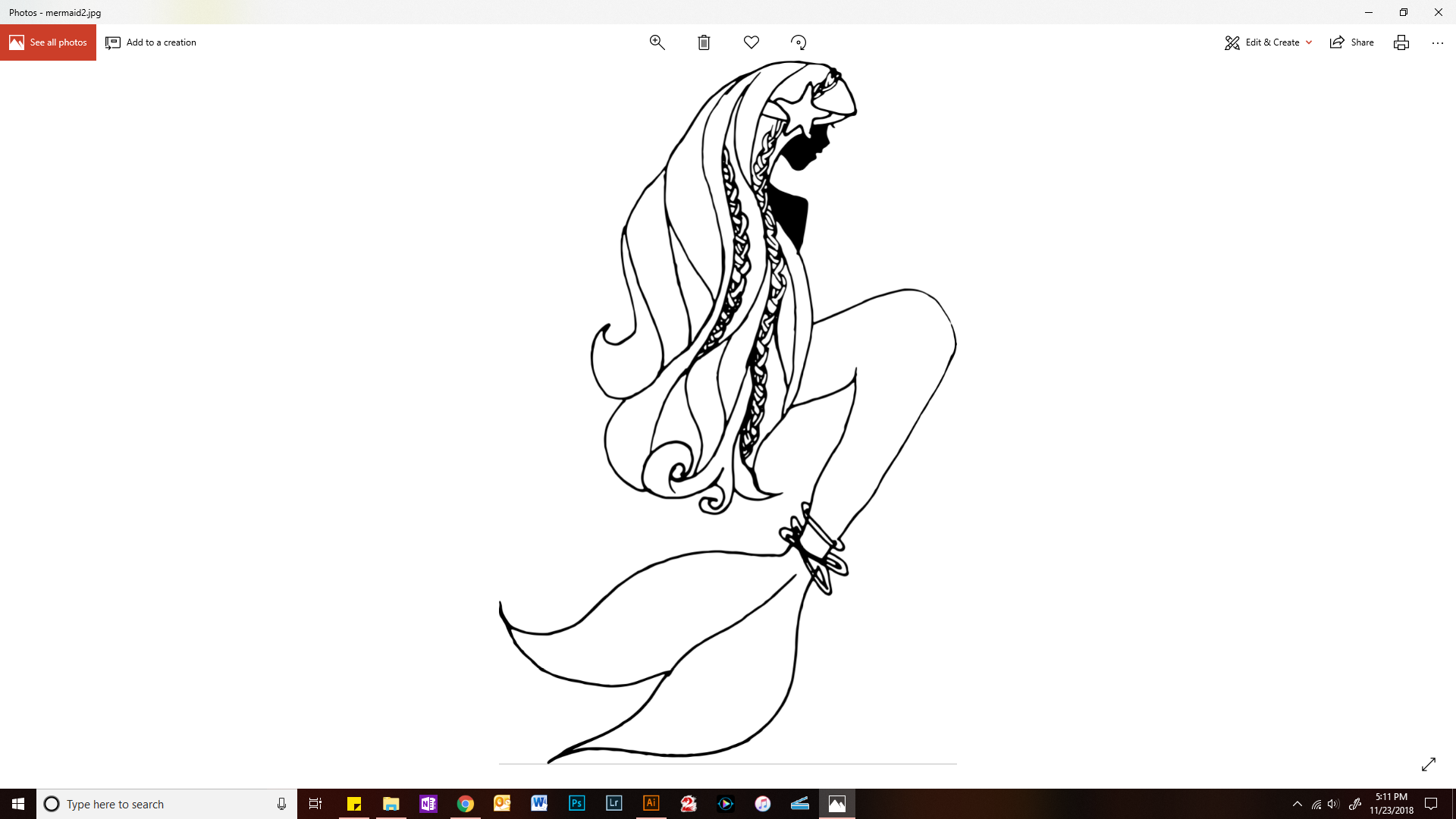

This is what I want it look like:
.png)

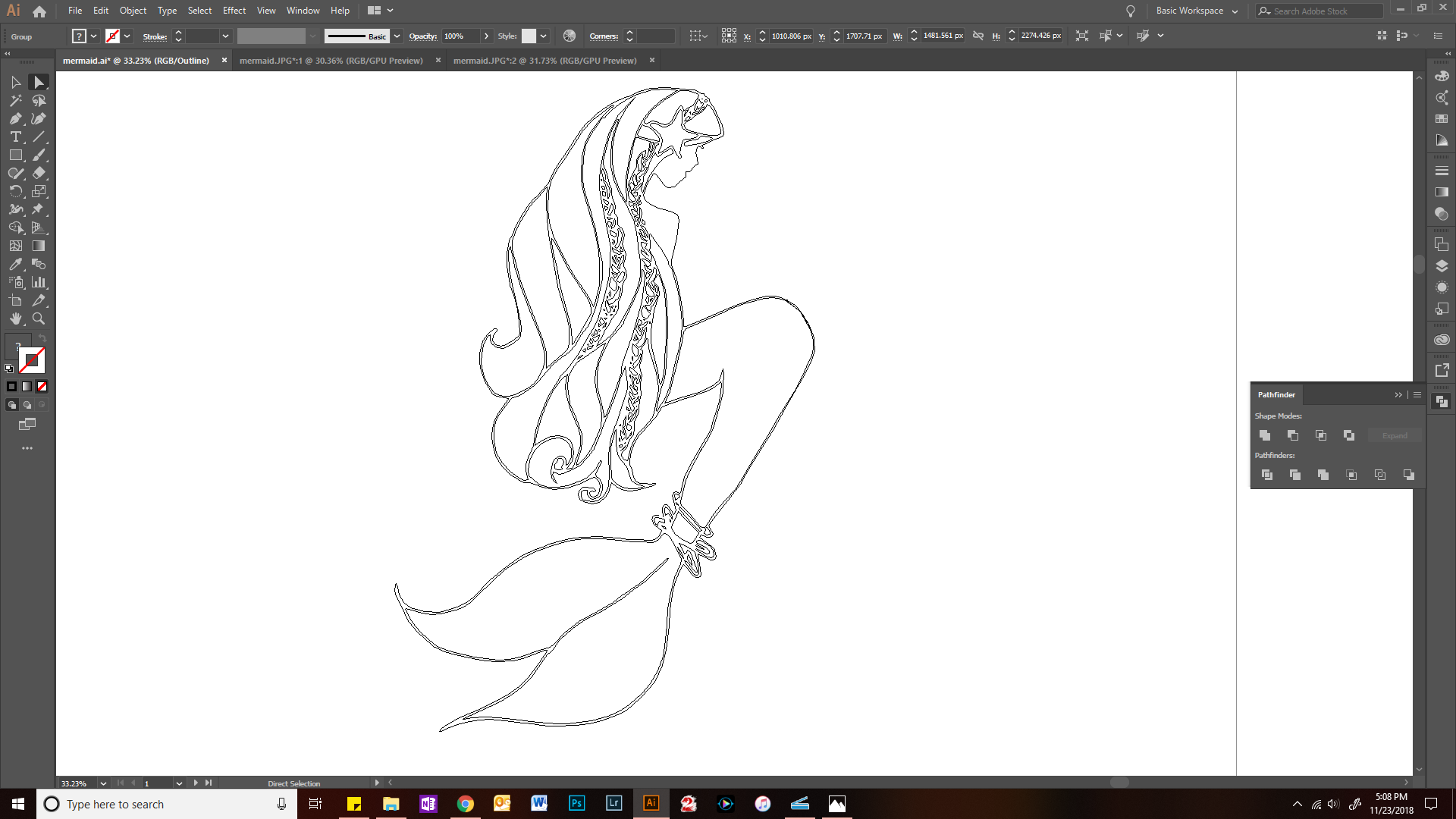

this is what the outline preview looks like, if that helps:
.png)

tried printing it. It looked like this in photos, and exactly like that printed:
.png)
I don't know. Still not as thin as I'd like it, but I think I'll just have to deal with it. I've been having troubles with image tracing for a long while now. I'm not sure what else to do, other than just accept the results as I get them.

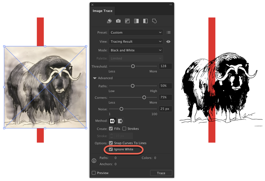

For next time, you might not be aware, but in the advance settings for the Trace Image you can knock out the white so that you just get the lines and don't have this issue. It may not work, depending on your drawing, but worth playing with.

Have you tried a (new) image trace with the setting Ignore White?
That should rid you of the issue, even before it arises.
