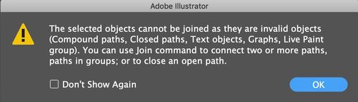

When bring 2 points together (right-click > Average) and then I try to join them together (right-click > Join), I receive an error message saying: "the selected objects cannot be joined as they are invalid objects":

Seems that if 2 points are part of the same closed vector shape, you cannot joine them, the solution is to delete the line between them, then before you join them together.

Are the points on the same path?
Participant ,
Jun 17, 2021 Jun 17, 2021
yes
If it's a closed path, in the pathfinder panel click on unite. This should help in a lot of cases.
And/or try Object > Path > Simplify

The "Unite" thing kind of works. Although my only concern is that it may do other things than just merge the 2 anchor points.
Jun 18, 2021 Jun 18, 2021
Without seeing your actual path, it's difficult to answer definitely. So what do you fear?
There's also a script for Merging overlapping anchor points http://shspage.com/aijs/en/

How about just deleting (the topmost) one of them with the The Delete Anchor Point tool (-)?

It will change the shape of the layer.

In some (simple) cases, you can get away fine with bringing 2 points together, but in many cases it can make a mess, sometimes obvious from the beginning. It may be better to make changes in other ways, also to fully obtain the desired shape.
A screenshot could be useful; it is easiest for helpers if you use the Insert Photos button at the top of the reply box.

Instead of doing it in two steps have you tried the shortcut Cmd(Ctrl)-Shift-Opt(Alt)-J? This will make a single point of two selected points.

if anybody is interested I solved it using this tutorial: https://youtu.be/r3GXhAFoX1A?si=36V09QIv4lrrhkMA
Two methods to merge troubled anchor points in Adobe Illustrator. More useful stuff by the author: https://svgsprite.com

Select both both anchor points with direct selection tool>Object>Path>Average path.
Then hit unite button in pathfinder.
