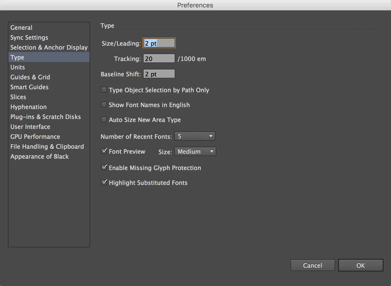

I've been doing research and it says to tick the Indic Option in Preferences>Type. But it doesn't have one. I'm pretty sure I have the English Arabic Version of CC.

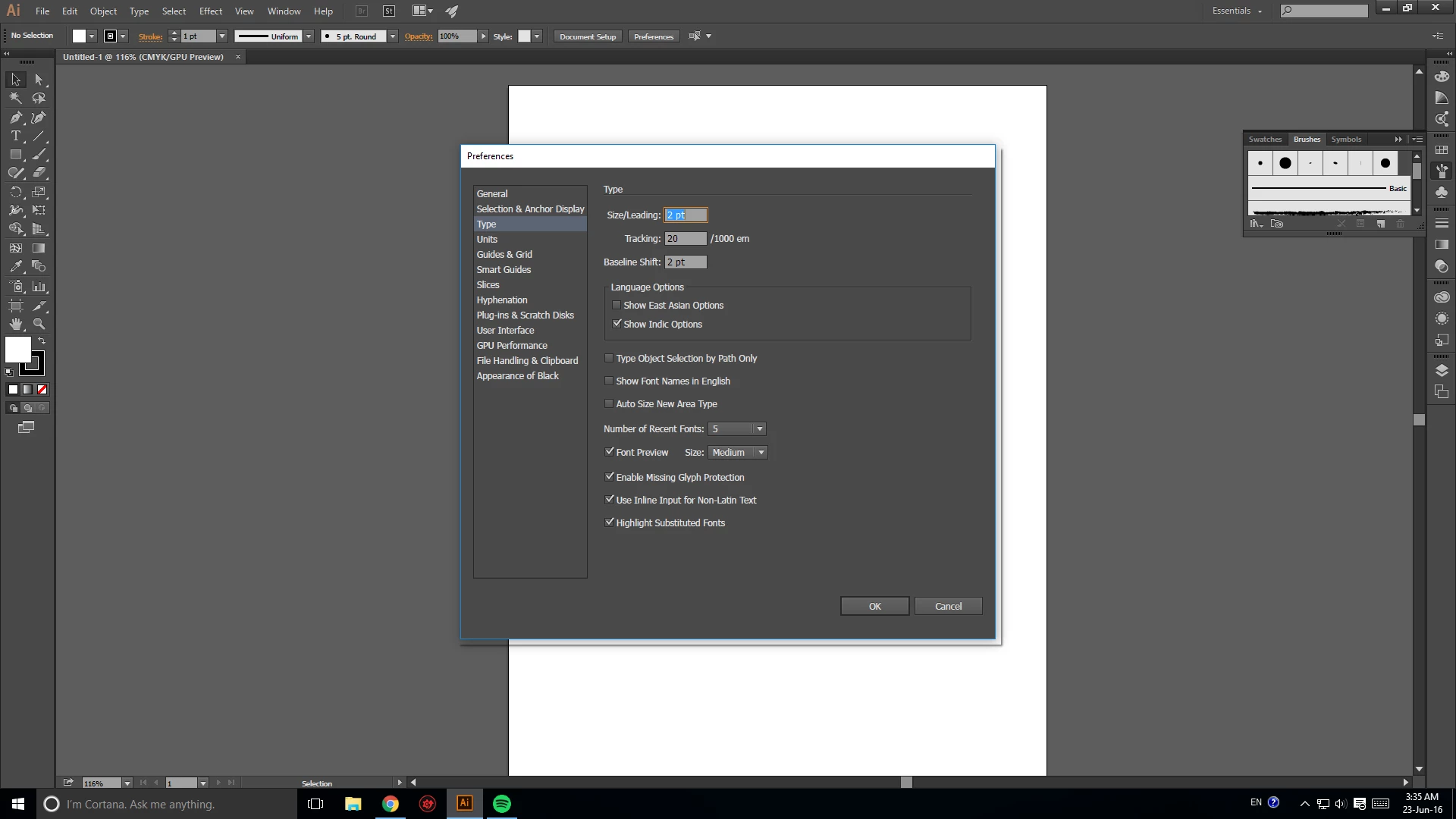

    Step one:
    Activate the "Indic type support" in preferences. See below:

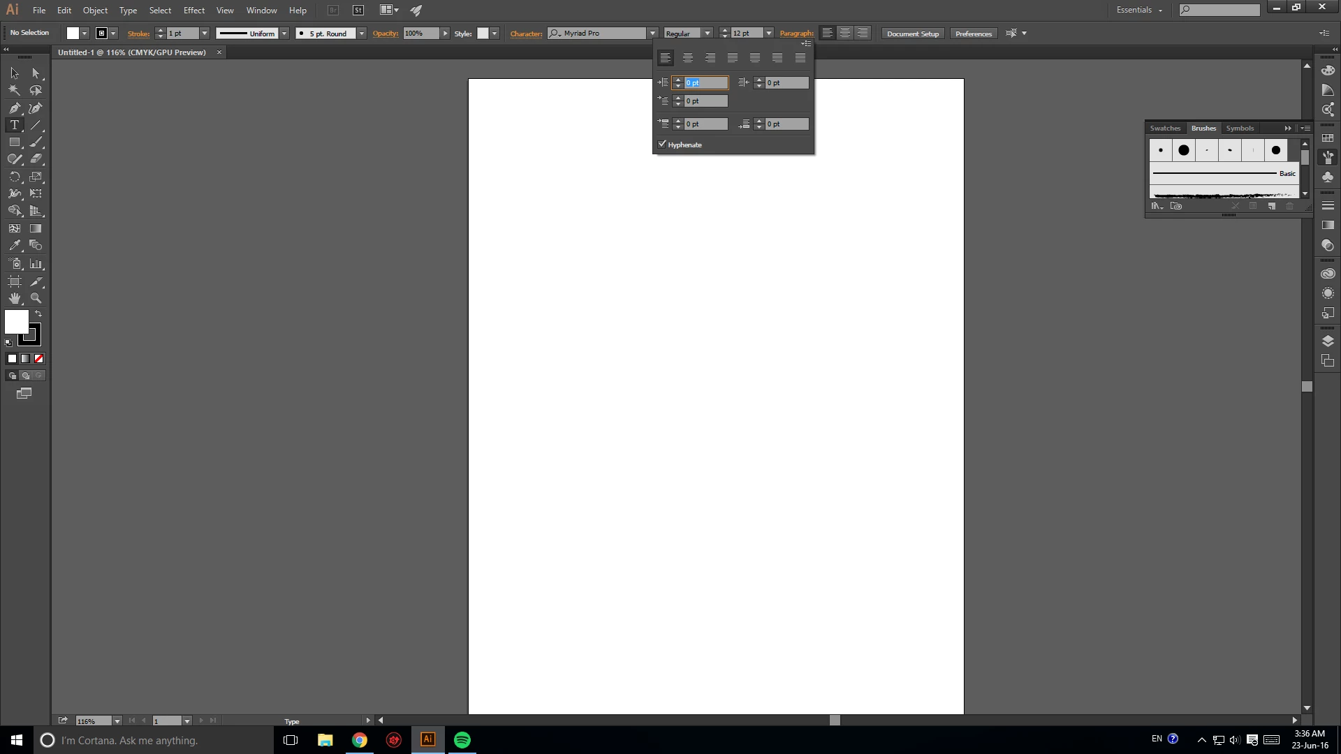

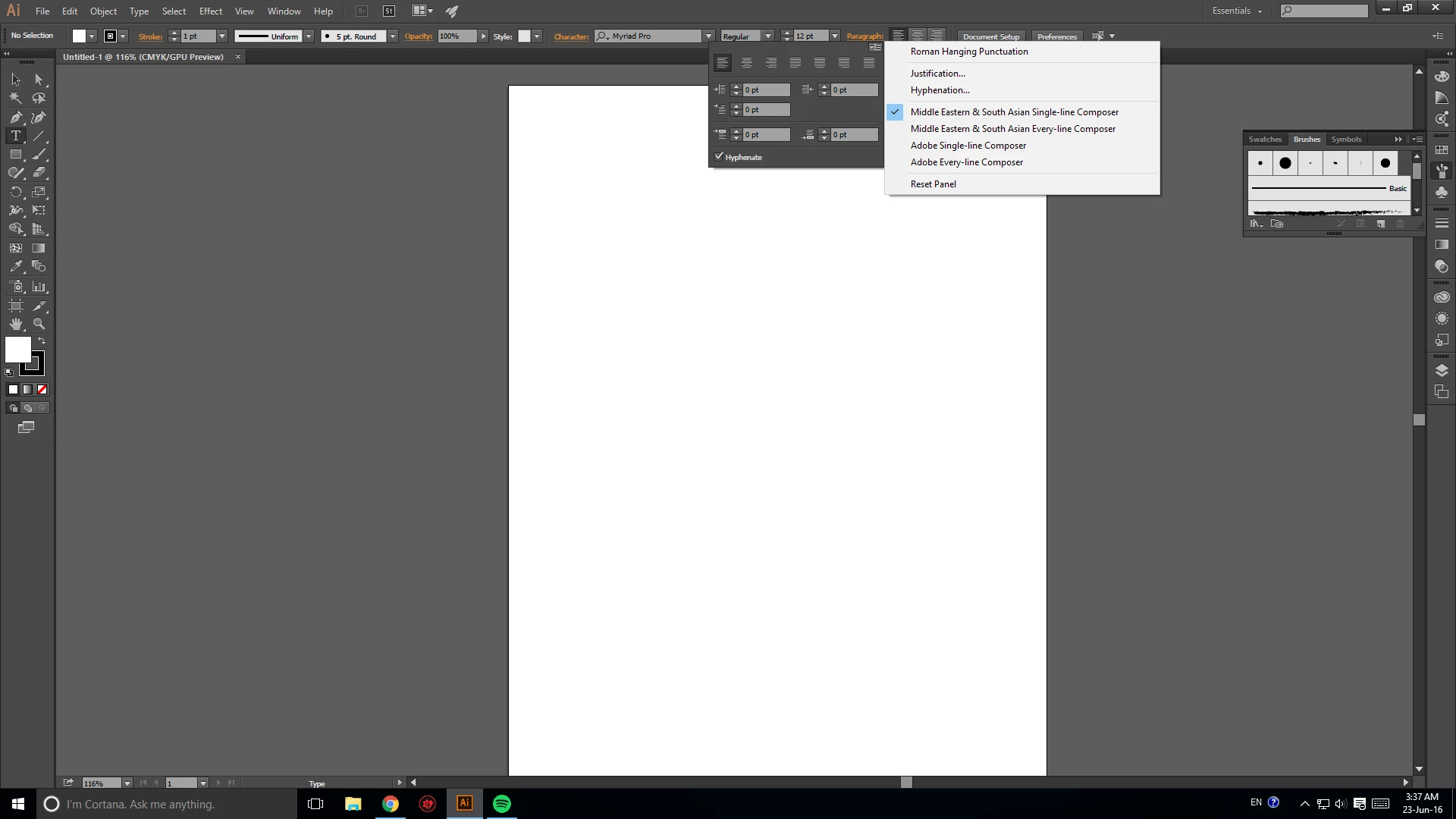

    Choose the TEXT tool ... Then click on "Paragraph" as shown below:
    Then click on the arrow on top right of the box and choose "Middle-eastern & South Asian single line composer"
    DONE!
