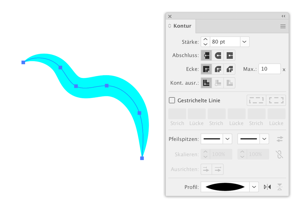

If you want a shape that is roughly the same, you could draw a lines along that butterfly wing and then apply a blue stroke and add a variable width profile to that.

Participant ,
Jan 09, 2021 Jan 09, 2021
Yes, I tried doing that but could never get the stroke to be perfect if I did things free handedly this way. That's why I wanted a better approach. Maybe in time I will be able to accurately draw out lines that are a lot more accurate, but I always seem to have to edit a lot afterwards and I find that to be time consuming.
