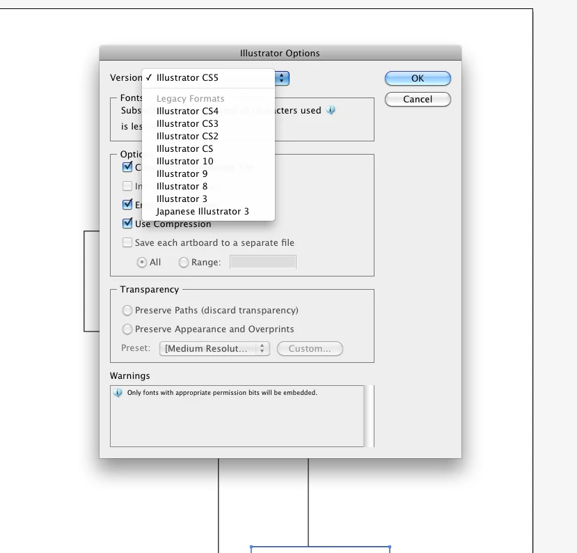

    You are looking for the option in the wrong place it is actually in the Illustrator options panel.
    Which shows up after you chose to save as to a location and you give it name to refresh your memory here is a screenshot

    The Illustrator Options dialog will come up when you click the Save button at the bottom right of the Save dialog after choosing .ai as the file type in the bottom center dropdown.
    June 4, 2010
    Larry, thank you so much for responding so quickly. BUT I'm still not seeing where you mean. (See attached screen shot.)

    You should be able to downsave it to CS4 when you Save (As) in CS5, CS4 being one of the options (along with CS3 etc). It will still be an .ai file which may be opened normally in CS5.
