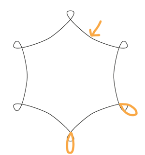

Hi, I'm probably being a complete idiot but I have a real mental block with this, can someone tell me how I make a pattern like this in Illustrator (CS6) please? I'd like to be able to make the loops bigger (and smaller) too as shown in orange but want all the loops to be exactly the same size, it all needs to be accurate.

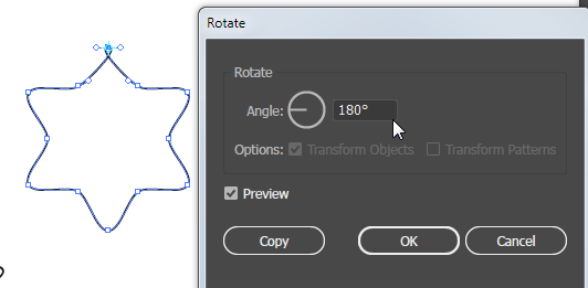

To make the top shape, select the star tool and click on the artboard. You'll want a fairly large Radius 2 in proportion to Radius 1. 6 points.
Select all but one of the anchor points with the Direct Selection tool.
Click the Convert to Smooth Anchor points icon in the Control panel.
Select just the last anchor point and convert it with the same icon.
With the Direct Selection tool, select just one of the outer anchor points at a time, double-click on the Rotate tool in the Tools panel, and rotate 180 degrees.
Repeat for each of the outer anchor points.
Select each of the outer anchor points, one at a time, double-click the Scale tool in the Tools panel, and adjust the scale.

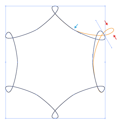

When I increase the size of the point, it does make the loops bigger but still not leaf shaped, you can see on my illustration the loop (in black stroke) is still squashed at the top (i have manually manipulated the shape, showing in an orange stroke, to illustrate the kind of shape of loop I'd like but this was done with lots of random moves of the handles and I'd like to do them precisely and together so they scale proportionally). I guess I have to edit the shape of the loops myself but as I say, the problem then is making all the loops identical.
Is it possible to pull in two handles from one anchor point at the same time to scale the loop proportionally - as shown with red arrows on the black stroke illustration? I'm thinking I shall have to draw one loop (with the a little path either side of it) as I'd like it and then repeat the loop every 60 degrees with the rotate tool and then join the paths all together?
I have added the blue arrow on my illustration to the middle anchor point because it is a rounded handle but it still isn't smooth, you can see it's slightly straighter in that area and I was wondering if there is a way to smooth it further, again, to do this proportionally with all the slightly unsmooth anchor points. If I do it manually there is a high chance the points will not all look exactly the same, hence why I'm wondering if it's easier to create one loop with a little path coming off each side and then repeat it every 60 degrees and then join them together? It seems long winded but I'm not sure how else to do it to get it all identical.
Thanks again for your help 🙂
Jun 21, 2017 Jun 21, 2017
Unfortunately, Illustrator does not have a way to pull two handles from the same anchor point to scale the loops proportionally. The only way to do that is by double-clicking a transformation tool and editing the handles in a dialog box, like the scale and rotate dialog boxes shown in my previous post. (You don't know how long I have wished for Adobe to add the feature you describe!!!)
Yes, to adjust the points by hand and make the object perfectly symmetrical, you'll need to create a portion and then repeat it as Doug is showing in his screen capture.

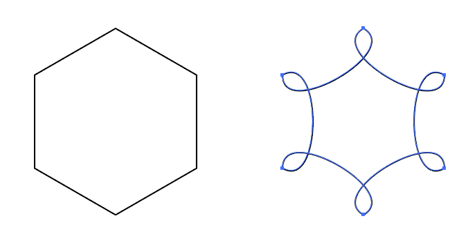

Use the fleurify script on a hexagon. Unfortunately there is not preview, but you can experiment with the numbers to get the loops you desire.
http://files.kaleidoscopechicago.com/_L5-DILbs8T8svR
CREATIVE_fleurify.js
5 KB
The URL will expire on July 20.

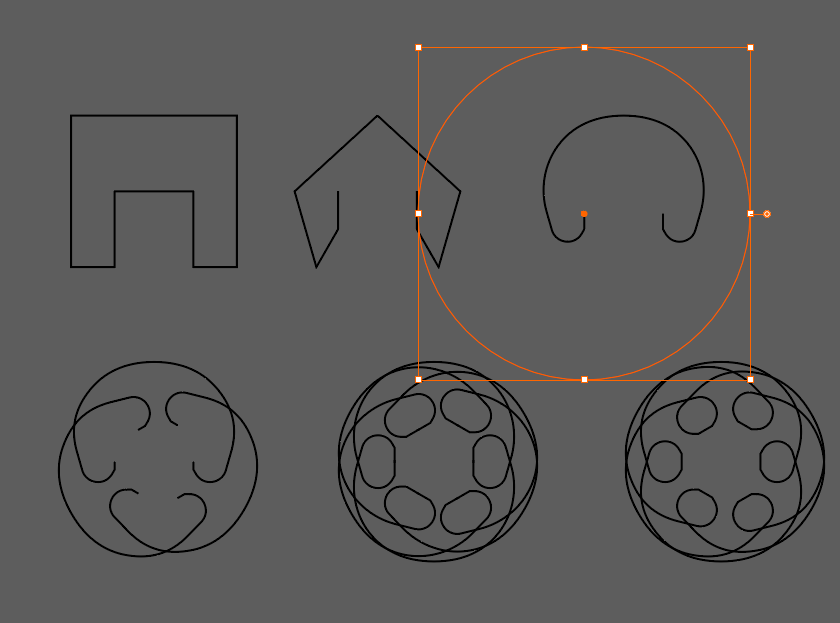

with a reflect and transform effect on a layer (and an invisible box), you could make it so you only have to edit one path segment to get a pattern that repeats around a spiral:
here's an AI file if you wanna take a look:
Dropbox - spirograph.ai

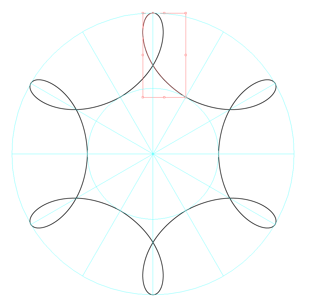

The closest I could come by spending a few minutes on this.
I used a circle filled and stroked none (shown in orange) which I group to my shape to offcenter my transform effect rotation (as in spirograph)
Would take some time to match exactly, but hopefully this helps give  some ideas.
