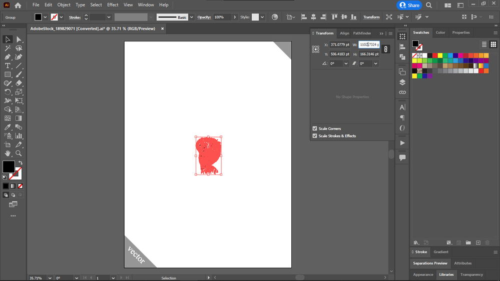

At 10% my owl became just a black patch.
This scale dialog wouldn't even let me scale it down:
So I scaled it down with the other dialog:

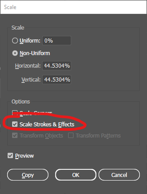

Make sure scale strokes is on. To get the dialog option click the scale tool.

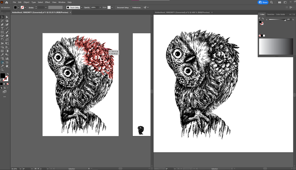

I don't know what you mean. How are you determining that the vector looks different?
This is your image. Both of these windows are the same document; Left shows the original owl and scaled down, right is zoomed in on the scaled down owl. They look identical:

I understand that, but looking at a comparison on screen is meaningless if you are printing it.
Copy link to clipboard
Copied
That happens because in vector format the paths stay ientical no matter the size. And in the moment they are presented on screen or output on a printer they are rendered into pixels.
The raster image is baked into new pixels when made smaller. Details get lost.
What causes the black patch is the antialiasing. Probably it will look better when printed, because the printer has a much higher resolution than your monitor. But we can't know that.
