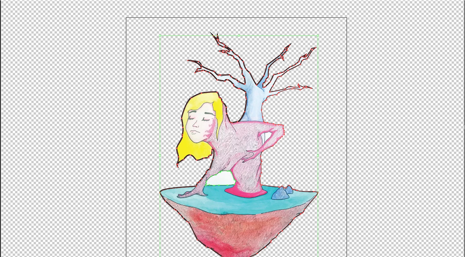

I need to make a hole in a clipping mask. Here's an image of what needs to be done:
The image, outlined in red, has been created using a clipping mask, and the the white part between the ladys'(?) arm and the grass is what needs to be transparent.
Basically, the white parts are a part of the clipping mask, and I need to make them transparent. How do I do this?
Thanks!
Correct answer Monika Gause
Release the mask. Then create a compound path out of the outer path and the hole. Reapply this as a clipping mask.
Kurt Gold
March 20, 2017
Use a compound path to create the clipping group (and don't forget to include the second white part next to the stem).
Monika Gause
Monika GauseCommunity ExpertCorrect answer
March 20, 2017

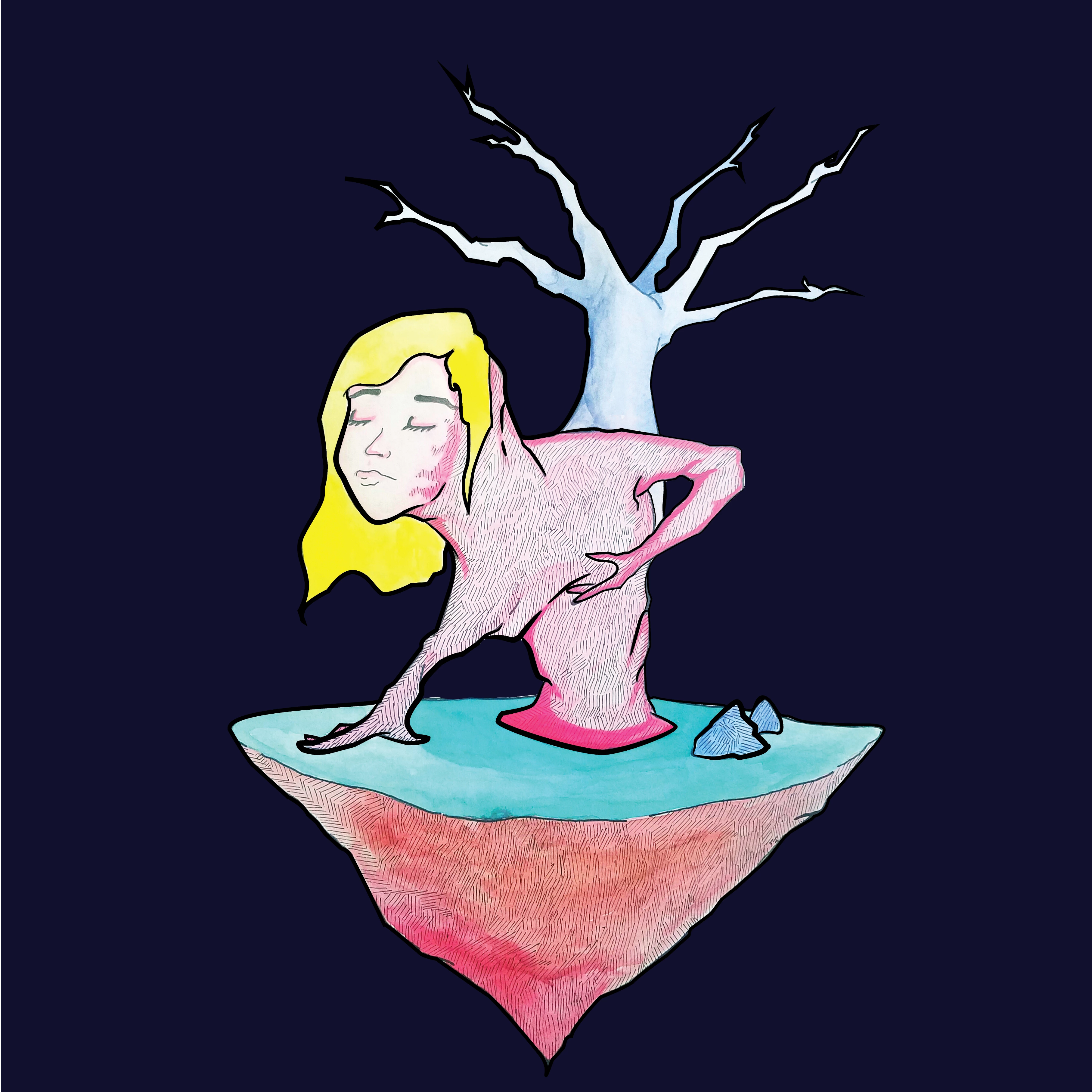

Thanks a ton, that did it! Here's the end result:
Do you happen to have any advice that may help an illustrator novice? Anything that would make the image look better or more engaging?
Thanks again for your help!
