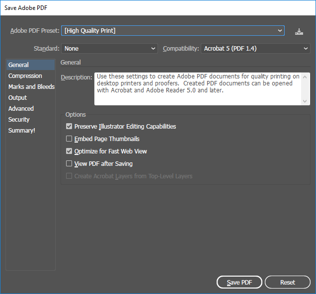

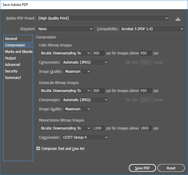

Below screens:

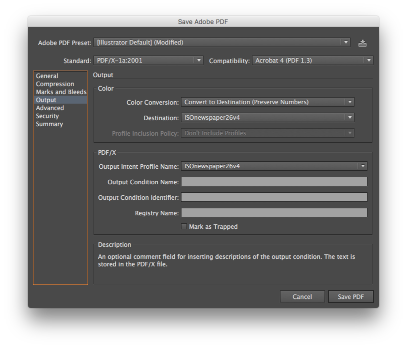

If your images are already in CMYK (fogra 39), they are not touched during export (because of "preserve numbers"). Open them in Photoshop, Edit -> Convert to Profile -> Adobe RGB (use intent: Relative Colorimetric) and then again Edit -> Convert to Profile -> your required 26v4 newspaper profile (use intent: Perceptual). This is for avoidance of not recommended CMYK to CMYK conversion, always go CMYK -> RGB -> CMYK. These new CMYK images use only for newspapers (include profile, also use "newspaper" in name to be clear in future).
Better, use original RGB images (if you have them), convert them to your 26v4 newspaper profile in Photoshop (use intent: Perceptual) and use in Illustrator or InDesign.
On export, i use PDF/X-1a, zero bleeds (there is no bleed in newspaper) and Trim, Registration and Page information with Offset 3 mm (or no print marks if required by client).  Use "Output Intent Profile Name" (in this case "ISOnewspaper26v4") for correct viewing in Acrobat. Is also useful "Page Information" to include in document (if someone sends you in the future renamed PDF, to find source).

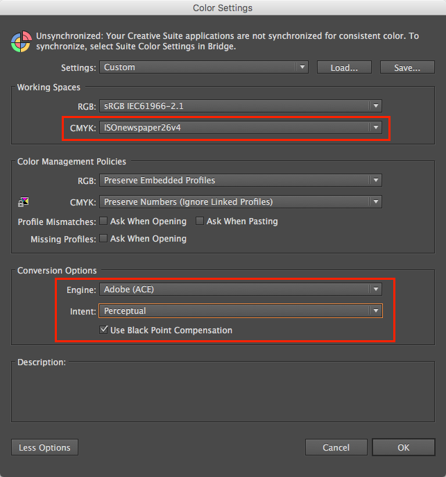

If use only Illustrator:
- set Illustrator’s Edit -> Color Settings to "ISOnewspaper26v4" for CMYK and to use "Perceptual" intent in Options (recommended by all newspapers i know):
- delete all existing bitmap images from your document and Edit -> Assign Profile "ISOnewspaper26v4" to your Illustrator document:
- now again place original RGB images back to your Illustrator document (they will be converted to "ISOnewspaper26v4" profile using "Perceptual" intent)
- export to PDF (use my settings above for example, 300 dpi as in your screenshot)
If done, be sure change Color Settings back to your normal, to prevent accidental use newspaper profile for other jobs (back to your fogra39 and Relative Colorimetric intent).
