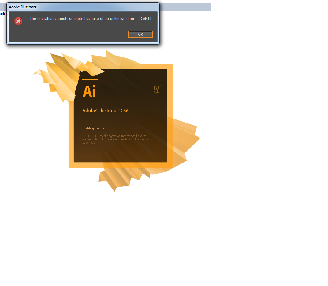

When I wrote a code for Tool Plugin It's gives a message like this
How I will resolve it .,Please assist me.

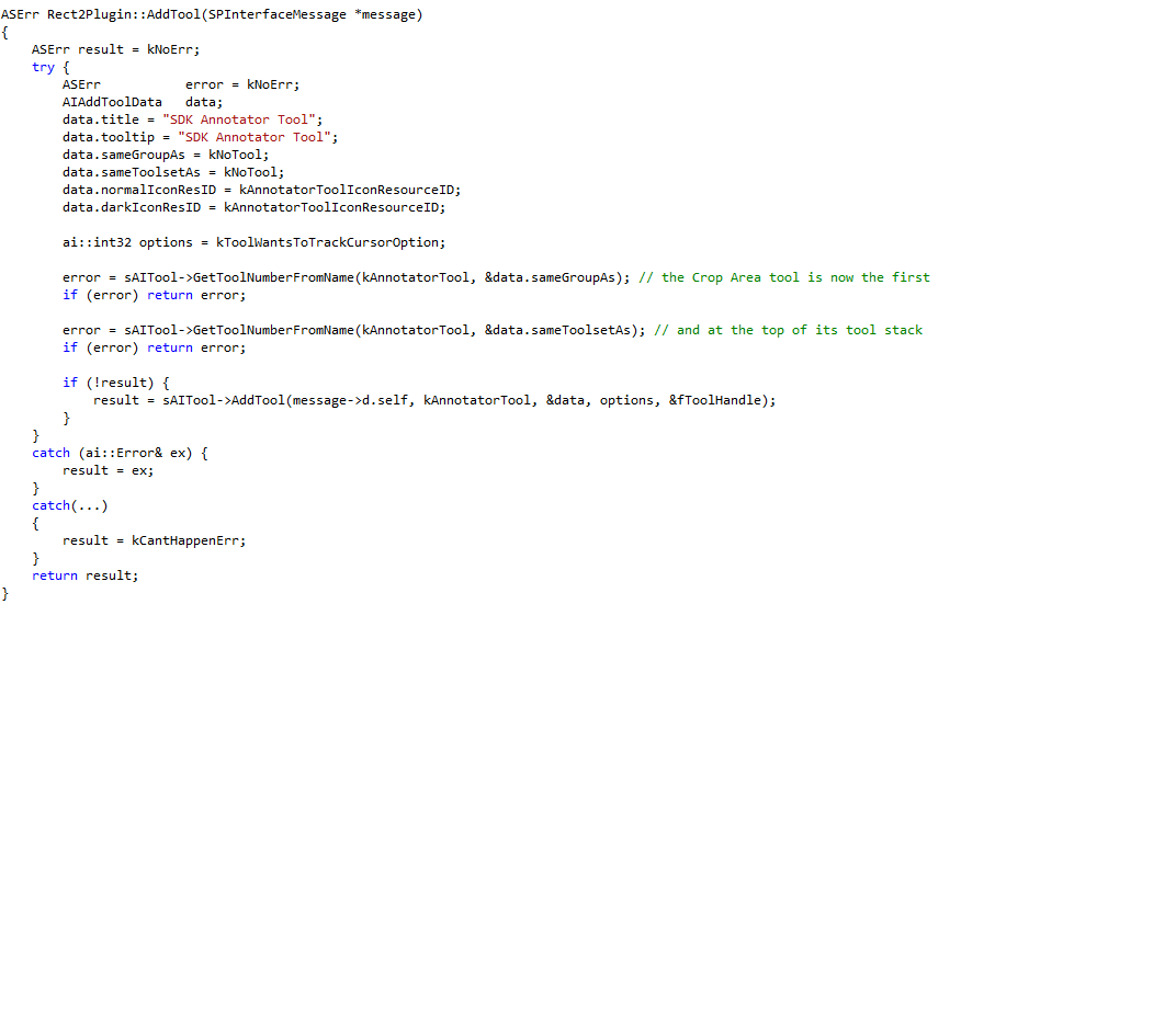

It's  the sample code  of Annotrator I  using this code inside  my project .
After calling Add tool  function inside  StartupPlugin ,It's  build successfully but when launching the
Illustrator CS6 It gives the error shown in 1st discussion .

You need to step through Rect2Plugin::AddTool in the debugger to find where the error occurs. My guess is that sAITool is NULL because you haven't added the tool suite correctly.

I had the same error message. Installing Illustrator CS6 16.0.3 update helped.

You need to initialize the sAITool Suite properly, This code may help you
sSPBasic->AcquireSuite(kAIToolSuite,kAIToolSuiteVersion,(void const**)&sAITool);
