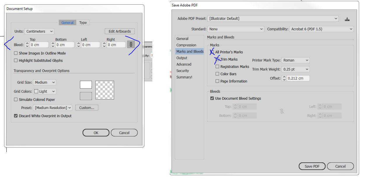

Answer above certainly works, but I prefer to add them within the "Document Setup".   File > Document Setup, then add the 5mm bleed there.  As long as 'chain link' icon is enabled it will keep all sides the same 5mm.  Then when you export PDF go to [Marks and Bleeds] tab and check off the printer marks you need.  (mainly Trim marks)

Hope so too!  Hope I didn't lead you astray with my screenshot.  I should have mentioned to ignore my PDF Preset, now that I look at it again. Should've assigned it correctly prior to snapping, sorry was rushing a bit.  As long as you choose a PDF preset to start with, then add Marks and Bleeds you want, they should output correctly to the PDF.  On the Illustrator file, you will see bleed represented as a red line outside your art board. If you don't see, Ctrl + semi-colon should enable it.
Here's a snap of one my presets, for a standard business card size. Personally I keep a few marks disabled to reduce visual clutter when they're not needed.  If they are, simply a check away!  Hope this helps for future prints.
