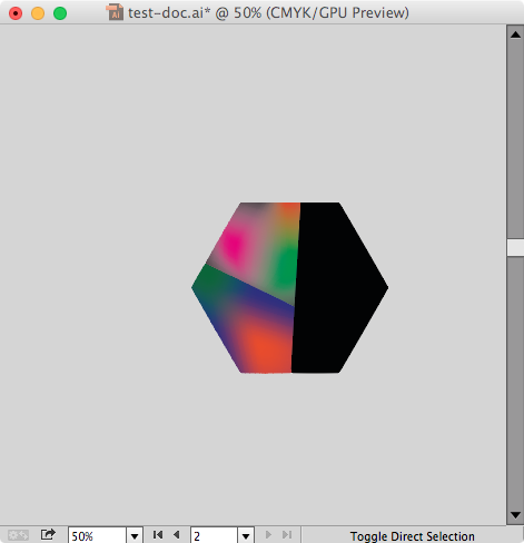

Community Beginner ,
Nov 18, 2015 Nov 18, 2015
Thank you so much for taking to the time to try solve this puzzle!
I tried the script but it still doesn't align, I am using this file to test it.
Dropbox - test-doc.ai
Screen Shot 2015-11-18 at 3.01.08 pm.pngScreen Shot 2015-11-18 at 3.01.07 pm.png
Note each group has several clipping mask, and it needs to align to the top-most and left-most clipped object.
I modified the script to not process the reference object as it is a single object.

I tried to solve this problem of detecting the top-most and left-most here with the following version of the script, and it looks like it's not looping through each clipping mask?
If you see the console, "All L" shoudl be all the left, i.e. 2 items, instead there is only one
Artboard 0
Group Item: 0
All L: -258.311776100257
All T: 339.395659174326
mostLeft: -258.311776100257
mostTop: 339.395659174326
