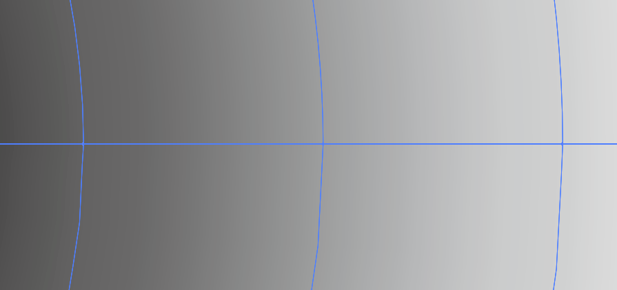

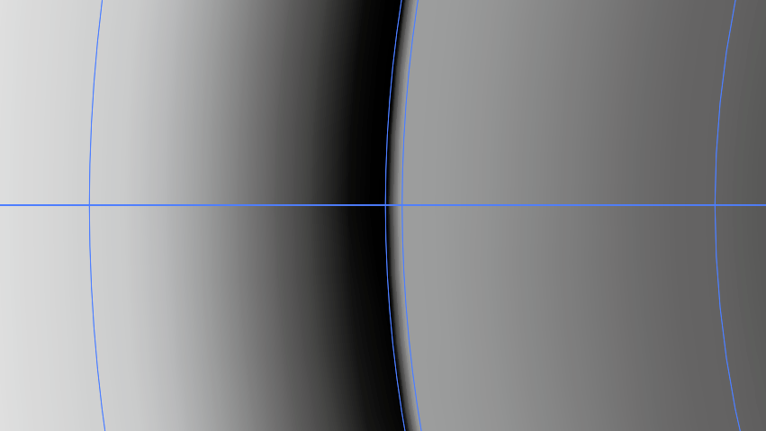

For a crisp divide you will need an additional mesh line very close to where you need it crisp.
Bildschirmfoto 2023-10-13 um 10.49.22.pngBildschirmfoto 2023-10-13 um 10.49.13.png
You can create that with the gradient mesh tool by clicking into the mesh where you want the line to be.
