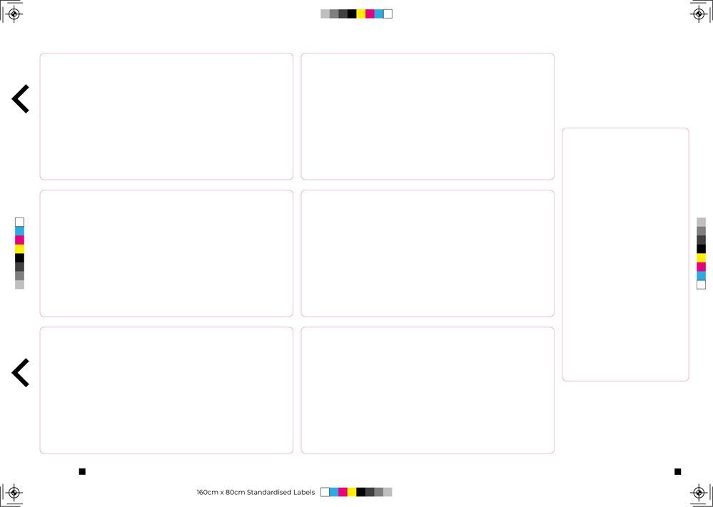

Community Beginner ,
Mar 18, 2020 Mar 18, 2020
I very nearly could get this to work! I just I need one of the artboards to rotate, and would have to delete the label which attaches to the main artboard. I've attached an image of what the template looks like 🙂
I basically want a label that would be designed on a separate document to copy over into the outlined areas on this template (the magenta outlines are the cutting paths, ideally don't want to change the format).
Label Print TemplateLabel Print Template
