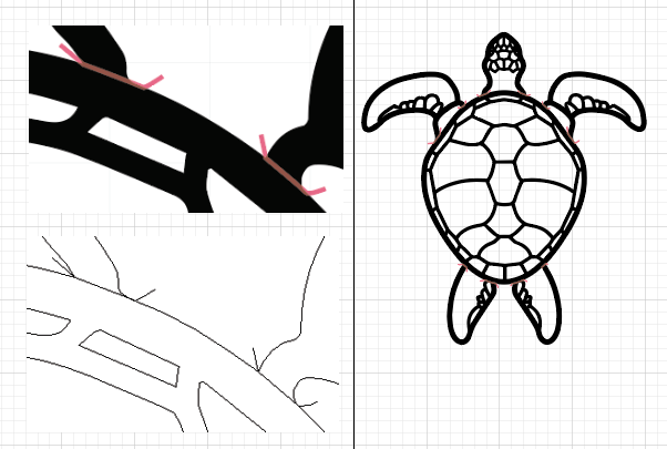

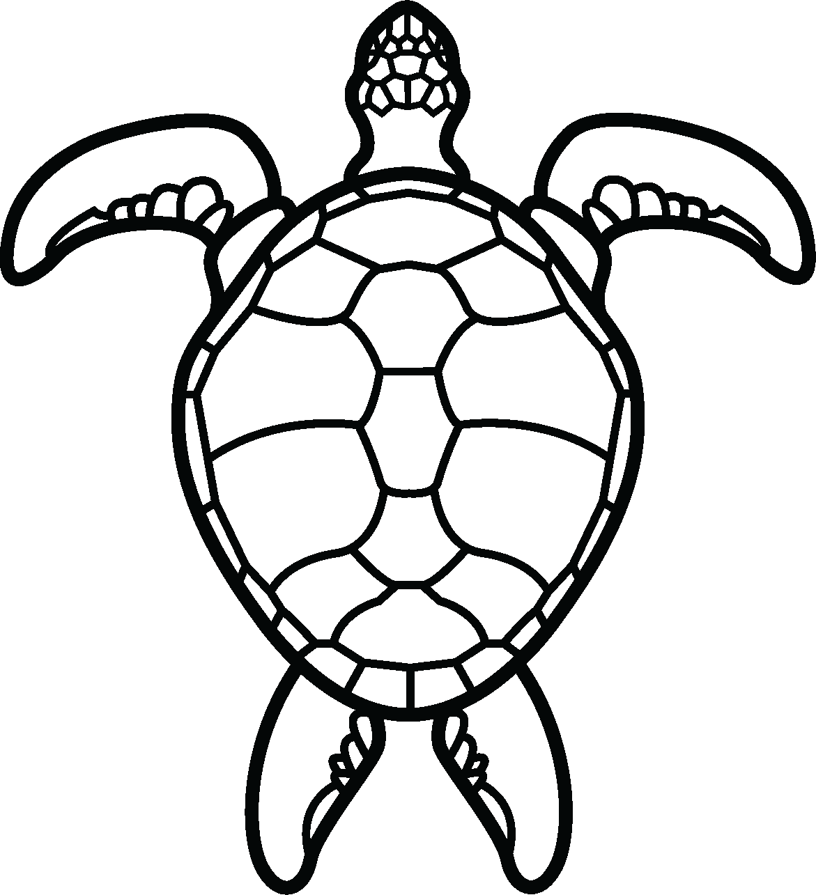

Hello. Hoping someone can help with this. I would like to just cut out the shell from this vector image. How would I go about removing the fins and head but keep the outside line smooth and uniform? Thanks for the help!
Correct answer kphotopage
Thank you for providing a screenshot with your paths selected and Layers Panel.
I'm assuming the problem here, your fill paths (turtle's shell and fins,heads) are united (in part). (compounded path)
Like Barbra said, there are many ways to do this.
First I used the Pen tool and drew some strokes at the joints.
These strokes will be used as “cutters”. Shown in red.
Next I used Live Paint Fills.
Then Expanded Live Paint, regrouped and labeled.

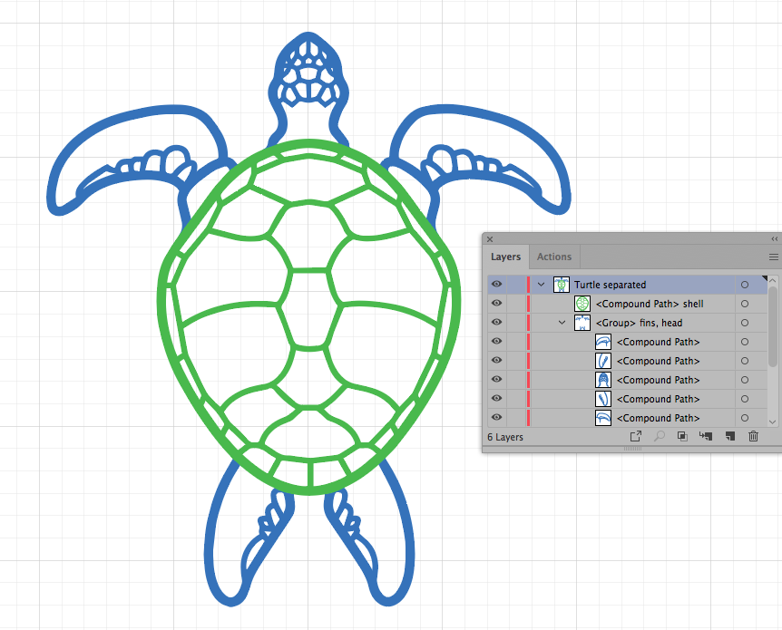

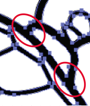

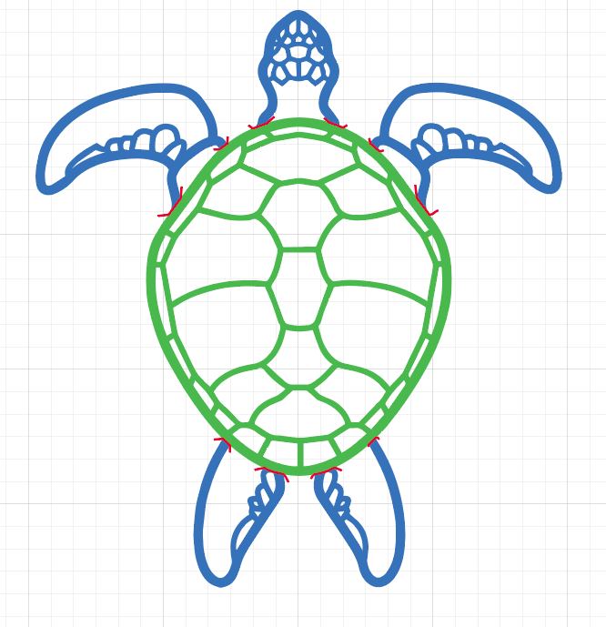

kphotopage
kphotopageCorrect answer
March 4, 2019

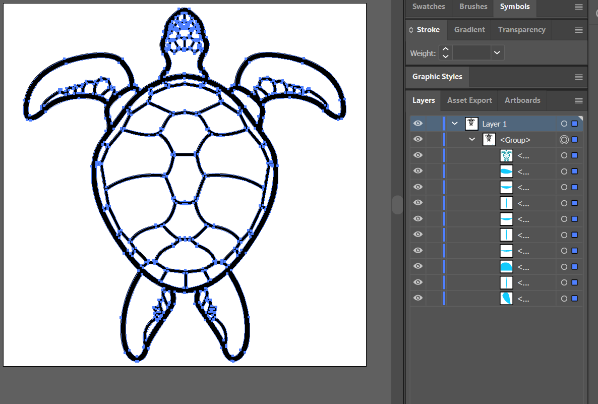

jane-e
March 3, 2019
Hi Matthew,
It depends on how it was made. Can you show the Layers panel and click the disclosure triangle to open it?
Is it a group? Is it made of individual pieces? Is it a compound path?
With luck, you’ll be able to select and delete the parts you don’t want. Otherwise you might need to use the eraser or scissors or Live Paint tools. We can give you a better answer when we know what you are working with.
Jane
matthewo78788568
March 3, 2019
Hi Jane,
Thanks for reaching out. Please see attached photo. I believe it is a compound path. As they are not individual pieces.
Thanks for your help.
