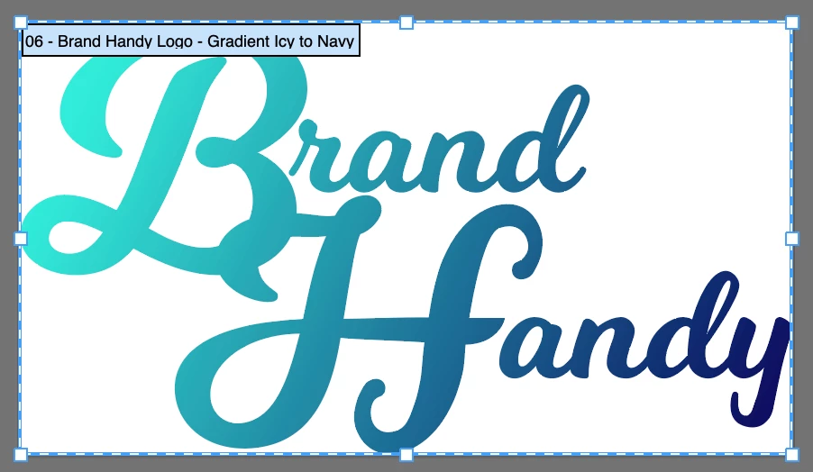

I'm trying to export a logo as an .SVG for my website but the export keeps adding extra white space for no apparent reason.
I’ve already tried Object > Artboards > Fit to Selected Art. - The artboard kisses the edges of the logo perfectly. (Looks like it's a bit cut off, but it's not when you zoom in)

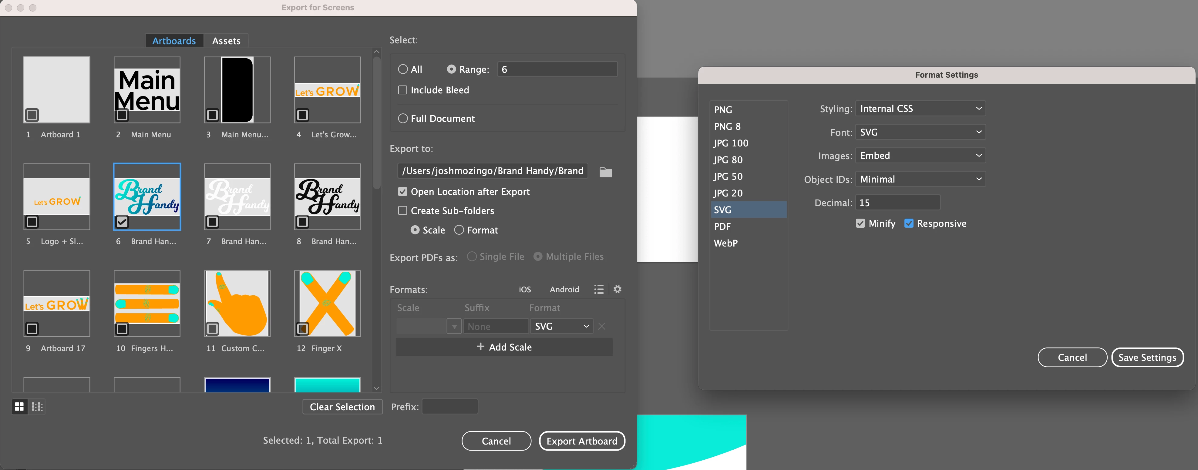

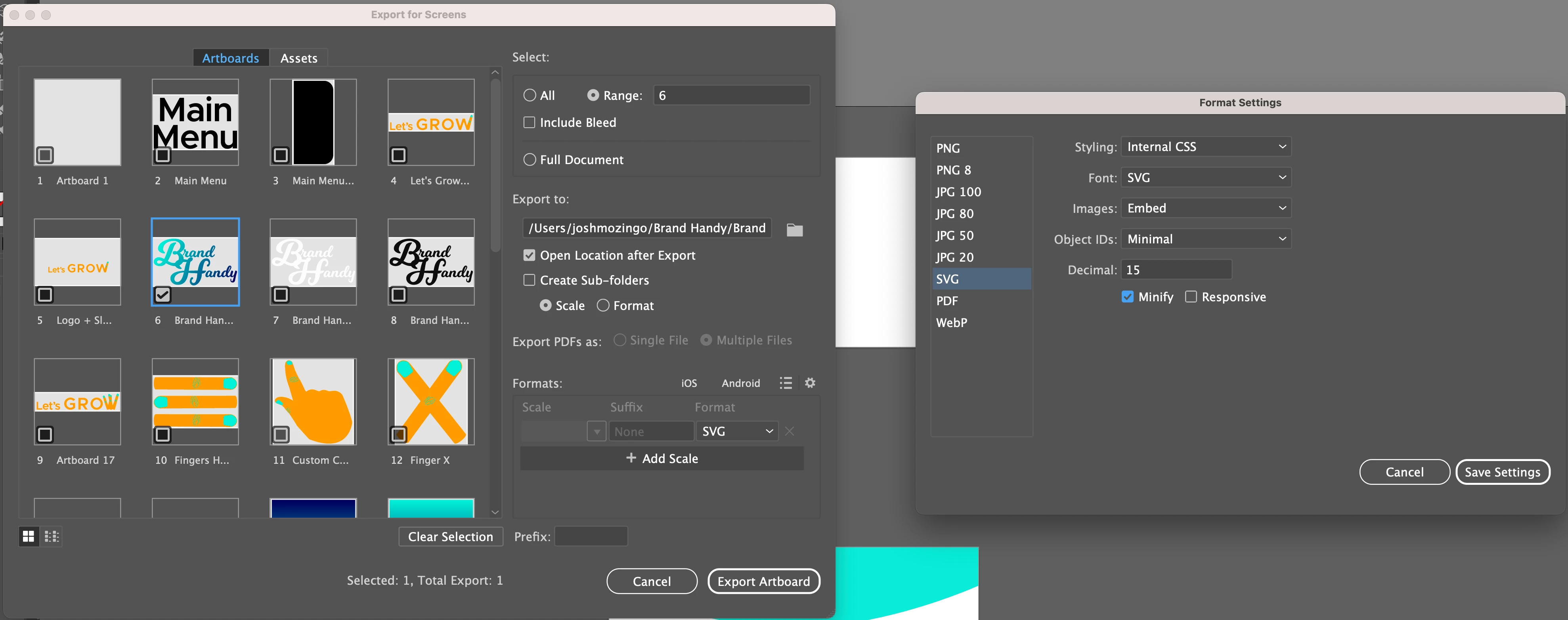

I’ve also tried Export for Screens > Advanced Settings For Exported File Types > SVG > Unchecked the Responsive box - All that did was move my logo to the top of the extra white space instead of being in the middle of the extra white space. From this advanced settings panel, I’ve messed with a lot of different combinations in this panel and nothing visually changes except for when I select, or deselect, the responsive box.
  Result of having the responsive box checked
 Having the Responsive box unchecked
