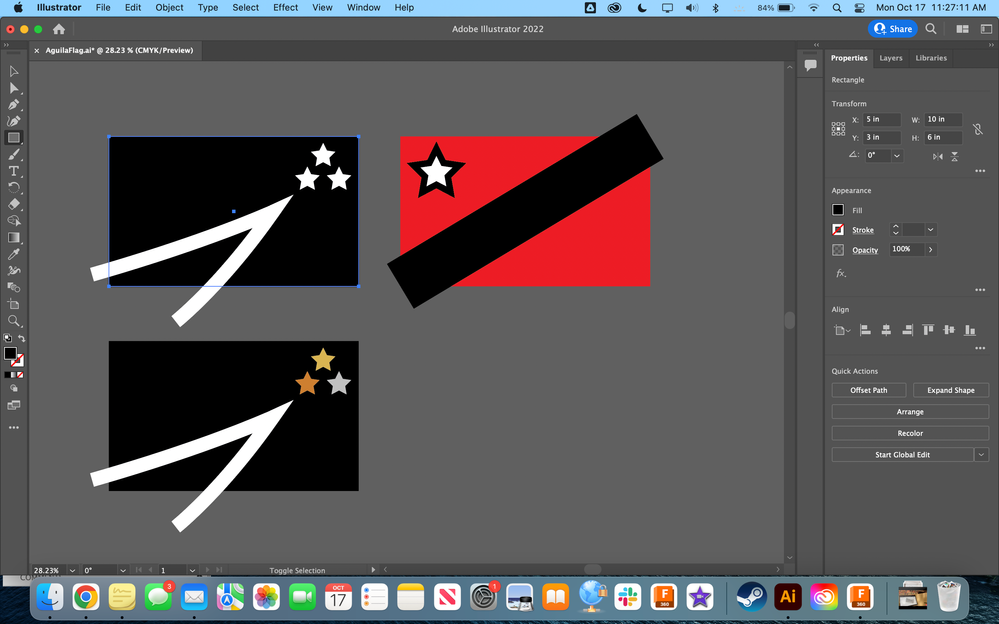

How to restrict a shape to another shape? Really simple, new to illistrator
New Here ,
Oct 17, 2022 Oct 17, 2022
Screen Shot 2022-10-17 at 11.27.11 AM.pngThis is going to probably sound really stupid, but how do I go about constraining all of the shapes on top of the rectangle to the rectangle itself so nothing hangs off. Thank you so much in advance, and sorry if this is a very simple beginner question.

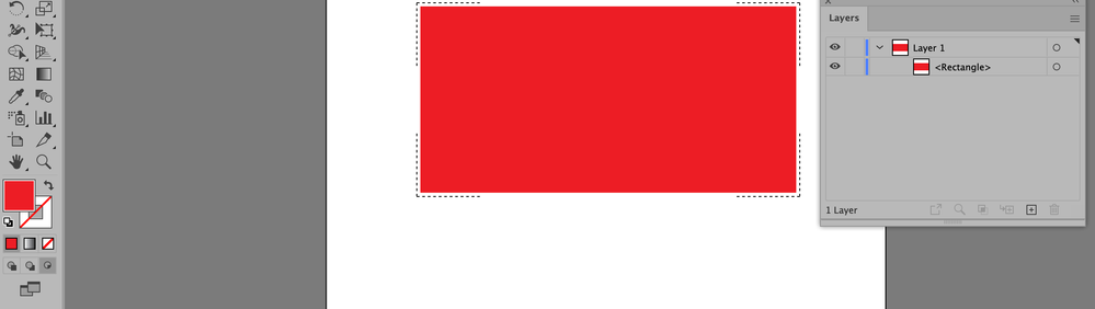

Starting here:
Open up your Layers panel. Select the rectangle and make a duplicate (Duplicate under the Layers panel menu)

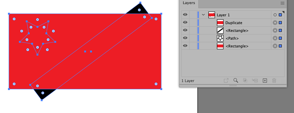

Select the Duplicate and drag it to the top of the stack.
With the Duplicate on top selected, choose Object > Clipping Mask > Make

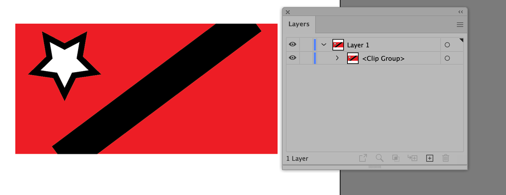

Here's the result:
