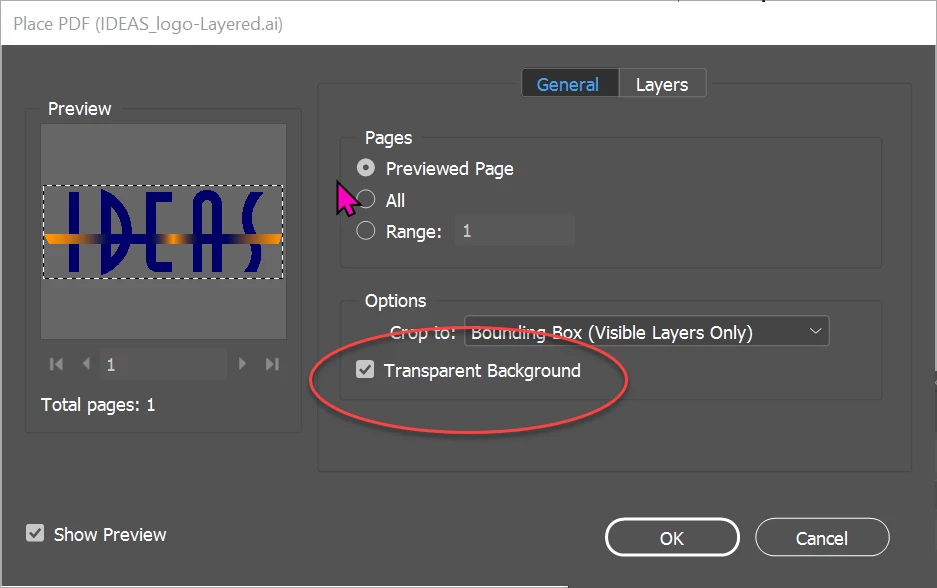

@Ton Frederiks post is referring to the Show Import Options when placing a file into InDesign. AI files are controlled by the PDF settings. Check to see if the Transparent Background is on.

Check the options in InDesign when placing the file. They are sticky, so when changed they stay that way.
Jul 15, 2022 Jul 15, 2022

Sorry, I just need to follow; When I place an ai-file in InDesign the "Place PDF" option should pop up – or where do you find this? 'Cause, when placing I am not given this option. 🤔
Jul 16, 2022 Jul 16, 2022
When Place is selected you need to click Options to get the Show Import Options checkbox.
Check that box, select an .ai file and click Place to get the dialog.
