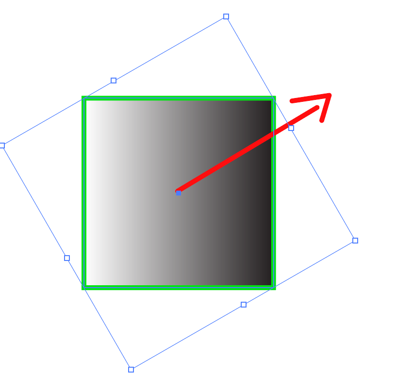

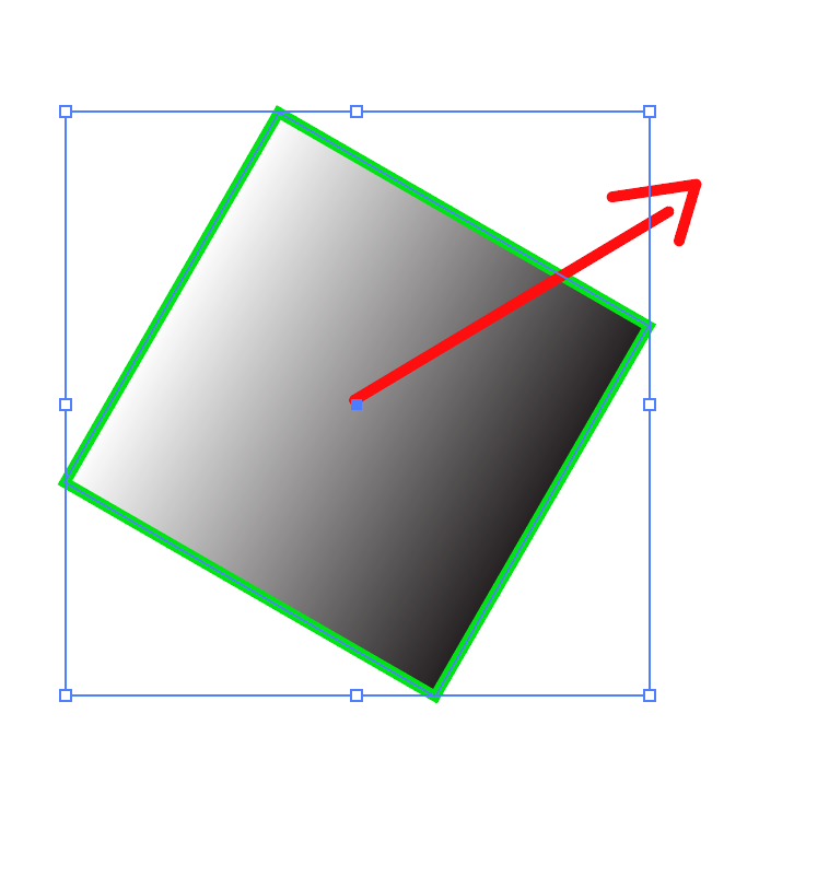

im attaching example photos of what im mean. First 2 images are what happens if i try to scale at any diagonal angle, it just scales a combination of x and y. The next 4 images is the tediuous workaround i found to scale at any diagonal angle. basically you rotate the opposite way, reset bounding box, rotated back, and then scale from one side of the bounding box. So im either looking for a way to scale one one diagonal axis, or im looking for a way to rotate the bounding box without rotating the object so that i can orient to do this faster.
