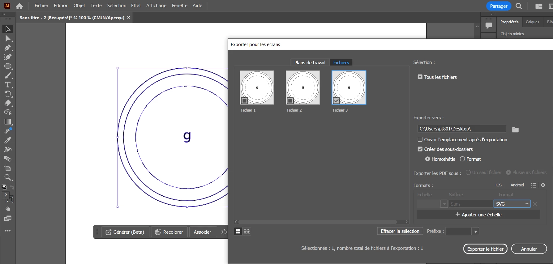

December 26, 2023
I have made my graphic and selected it,  then I have done "File/Export the selection" and would like to export my selection in SVG :
Is it possible to export the selection with a little margin that I could set ? How to set this margin ?

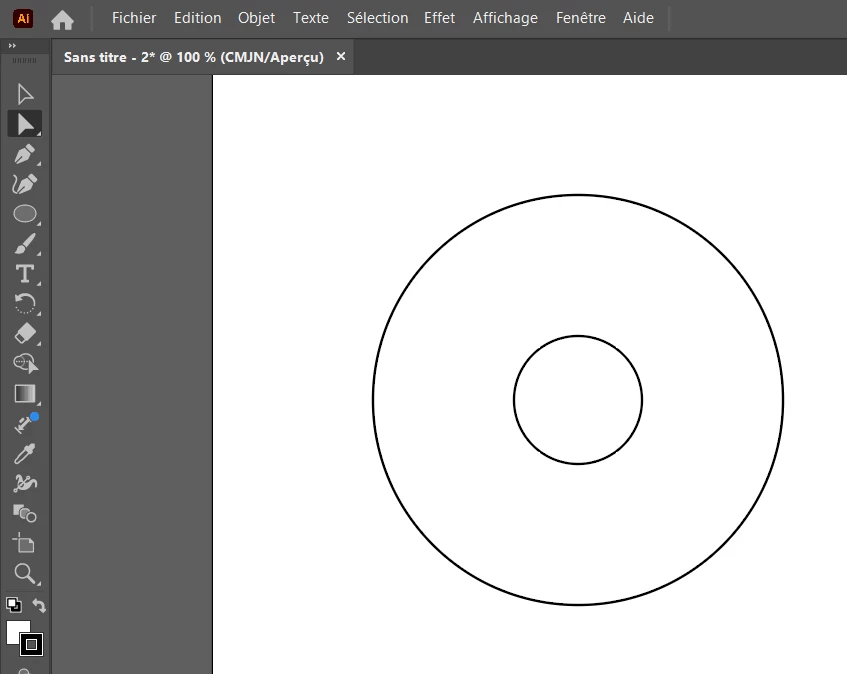

December 25, 2023
Hi Jacob,
In fact, I would like to keep the external circle with no change on the diameter, and would like to set by example a distance of 10 pt between the external circle and the inner circle. So the inner circle only will have automatically a change on its diameter. How to set this ?
Jacob Bugge
December 25, 2023
Pierre,
k gave the solution to that case: the Offset Path = Décalage, in the Tracé part of the Objet dropdown (see below).
If you delete the smaller circle and simply use the value -10pt (negative because you make a smaller circle inside) as offset, you are done.
For the translation above, I have relied on this valuable source kindly made available by Monika,
https://www.vektorgarten.de/illustrator-polyglott.html
It can also be used in connexion with other cases where you may need to know what we of lacking French skills are talking about,
Jacob Bugge

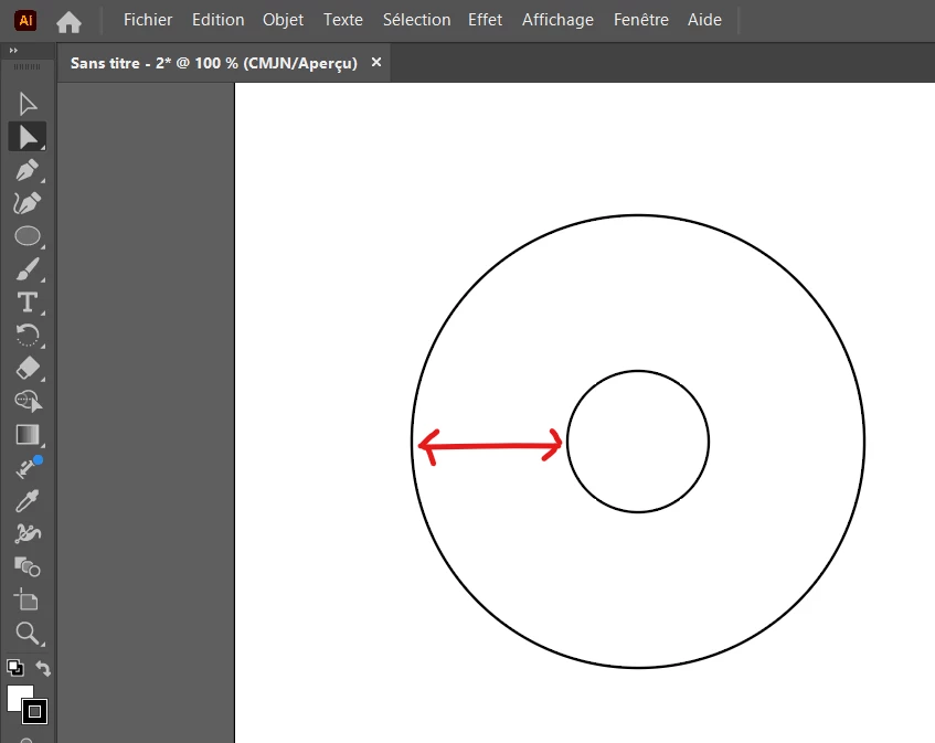

December 25, 2023
Pierre,
As I (mis)understand it, and believe that both Monika and k do, you wish to have two concentric circles with a certain difference in radius shown with the red double arrow in your second screenshot.
If they are to be concentric, the distance can only be the difference in radius (hafl the diameter, as in the W value).
This means that if you have chosen both diameters and the distance = difference in radius is wrong, you will have to change either or both diameters.
If one of them needs to have a certain diameter, you will have to change the other one, or create a new one which you can do as shown by k.
Otherwise you will have to choose both diameters knowing that the differnce must be twice the value represented by the red double arrow, with an infinite number of possible sets of values.
If on the other hand you wish to keep the existing diameters of the circles and change the difference in position of the leftmost Anchor Points of the circles (with the red double arrow in between), you can Align them horizontally (Align panel), presumably with one of them as key object to stay in place and then move the other one by the desired distance.

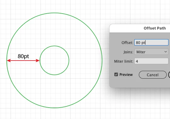

December 25, 2023
Pierret, Hi.
To set a specific distance between the two circles, you can use Object>Path>Offset.
In the Offset dialog box, type in the distance you desire.
K
December 25, 2023
Hi Monika,
My goal is to set the distance between the two circles (see red arrow), in pt.
Monika Gause
December 25, 2023
So you want a certain diameter for each of those circles?
