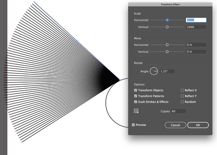

I'd use Transform Effect.
One line wtih Effect > Distort and Transform > Transform applied with whatever settings work for you.
