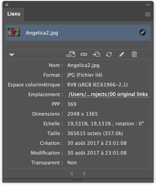

Gaétan, what does your Links panel tell you about PPI and Scale?
