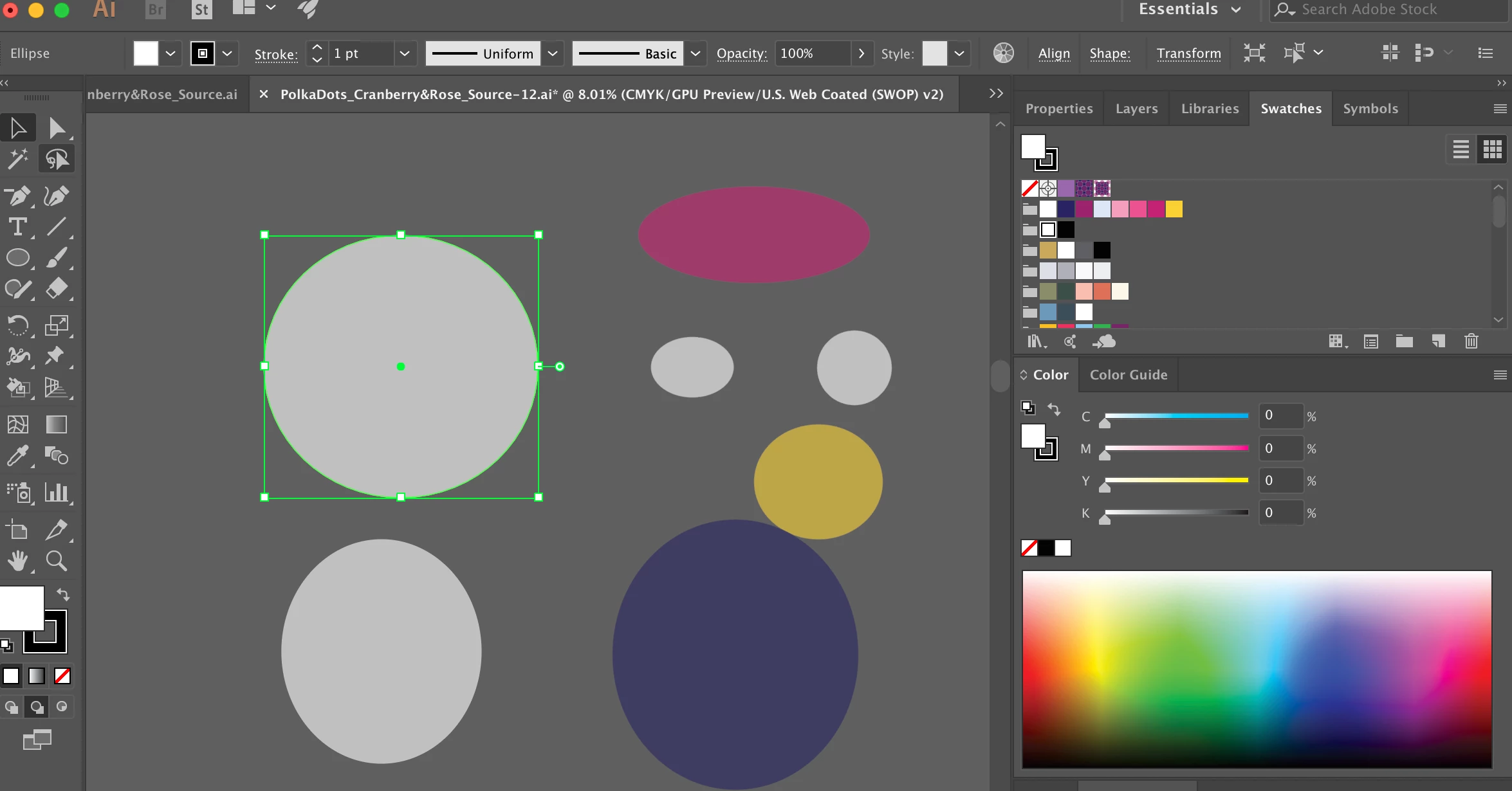

All of the white swatches are appearing gray in the object fill or stroke.  It dulls any other color swatch used, too.
It does not do this in every file.
I have made sure everything is in CMYK, not grayscale.
Here is a screen shot:
Thanks for your help!

    I would suggest that perhaps you have a reduced opacity applied to the layer containing these objects.
    And the tab at the top of the document in your screenshot shows that it is indeed in GPU view.

    That makes sense. I have checked transparency. Upon your suggestion, I went through every layer and everything is saying it is at 100% opacity. Is there another place to look for transparency besides each layer? Just for comparison, I did dim it down to 80%, and it does make it more faint, but at 100%, it is still faint.

    Does it get better when you work in View > Preview on CPU?

    It is in CPU Preview.
