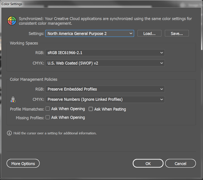

Here are my color settings. I don't ever change them and rarely have this problem. Most times I can fix it by creating a new file or restarting illustrator, but this file is being stubborn.Capture.PNG

What happens if you choose Emulate Adobe Illustrator 6.0 in the Color Settings>Settings dropdown, instead of North American General Purpose 2?
May 29, 2020 May 29, 2020
Choosing "Emulate Illustrator 6" isn't a solution.
If the values keep changing after opening the file, then it's caused by bad settings in color management. But in those settings (as in screenshot above) I can't see why that conversion should happen. The Secure CMYK workflow is already turned on and profiles get ignored.
It might be an error with the file or maybe Illustrator is not working correctly.
