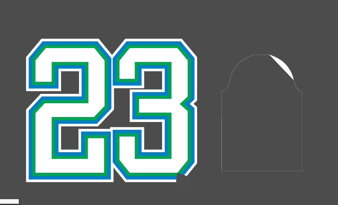

Sep 09, 2015 Sep 09, 2015
no resolution at all on this???
Adobe is awfully disappointing since CC came out... and it seems that every "update" things get progressively worse. Not even just with regards to scripting.. In CC 2015 we've had some issues with live text having jacked up anchor points where they don't belong and missing anchor points where they do belong resulting in pie shaped pieces cut out of the stroked appearance of certain letters. I've also seen strokes that have been expanded into compound path fills have anchor points go missing (see screenshot).
When is adobe going to get their act together and actually start responding to the professional community about this stuff?!?!?! frustrating as hell.Screen Shot 2015-09-09 at 3.10.23 PM.jpg
